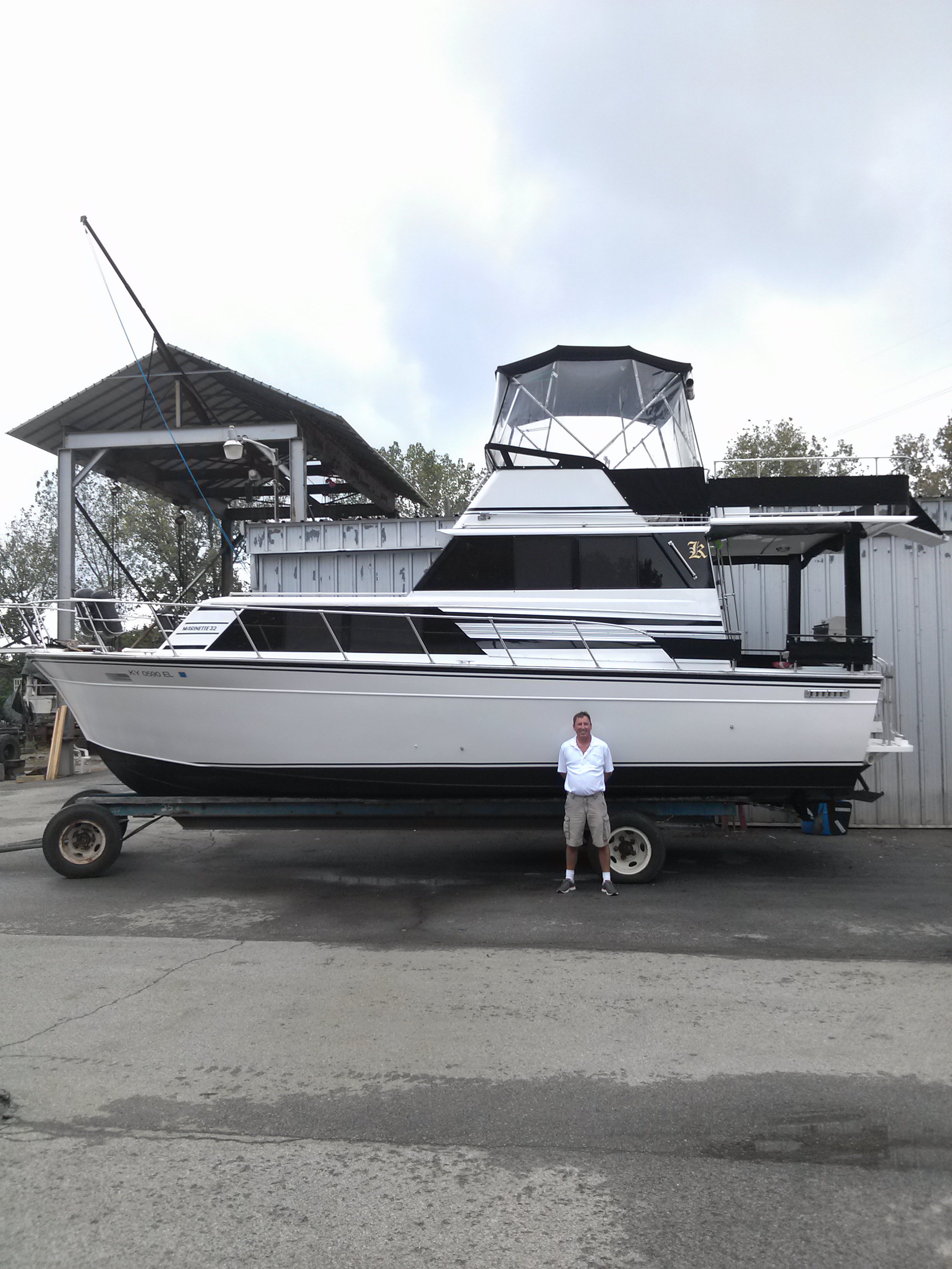

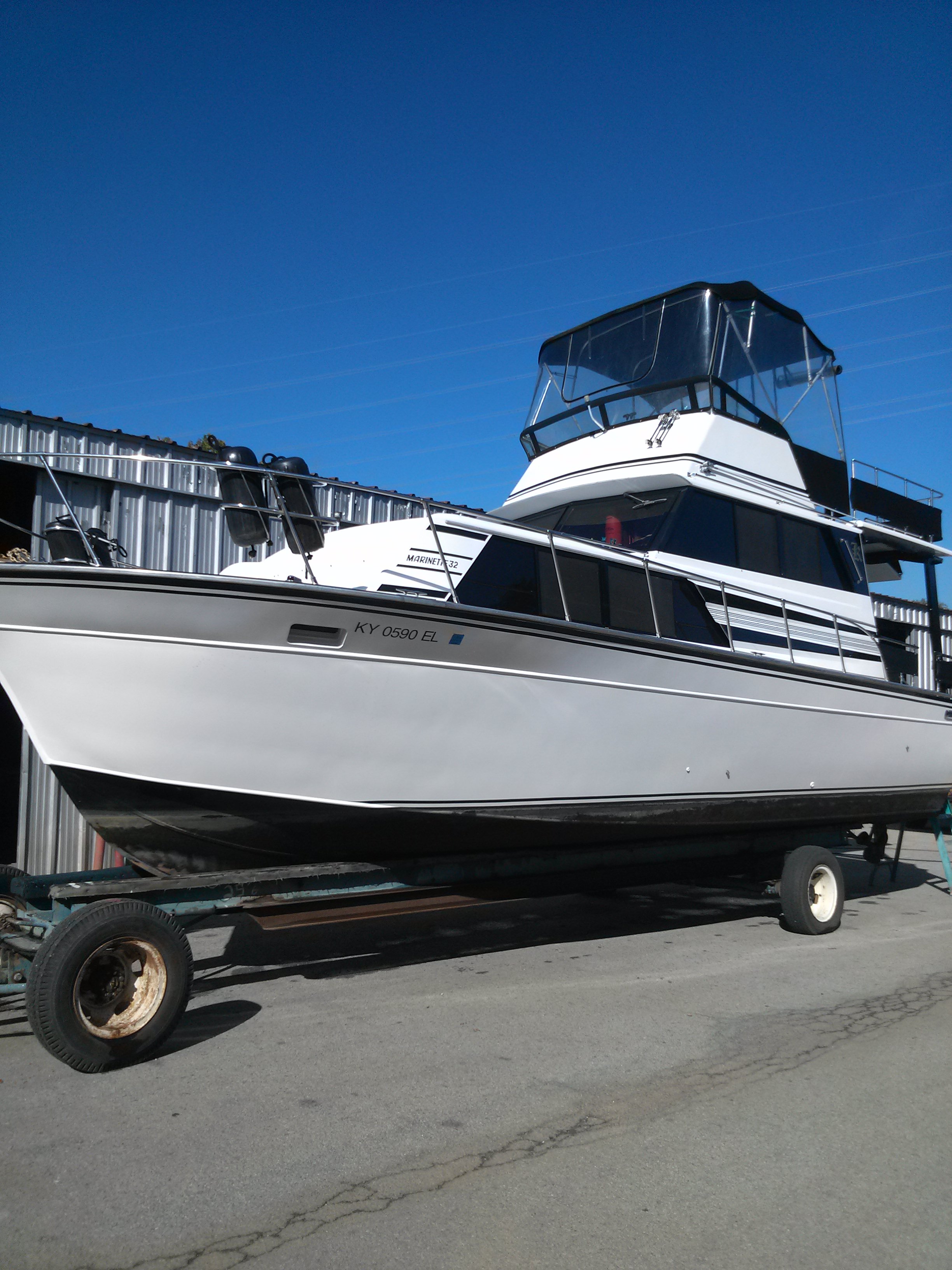

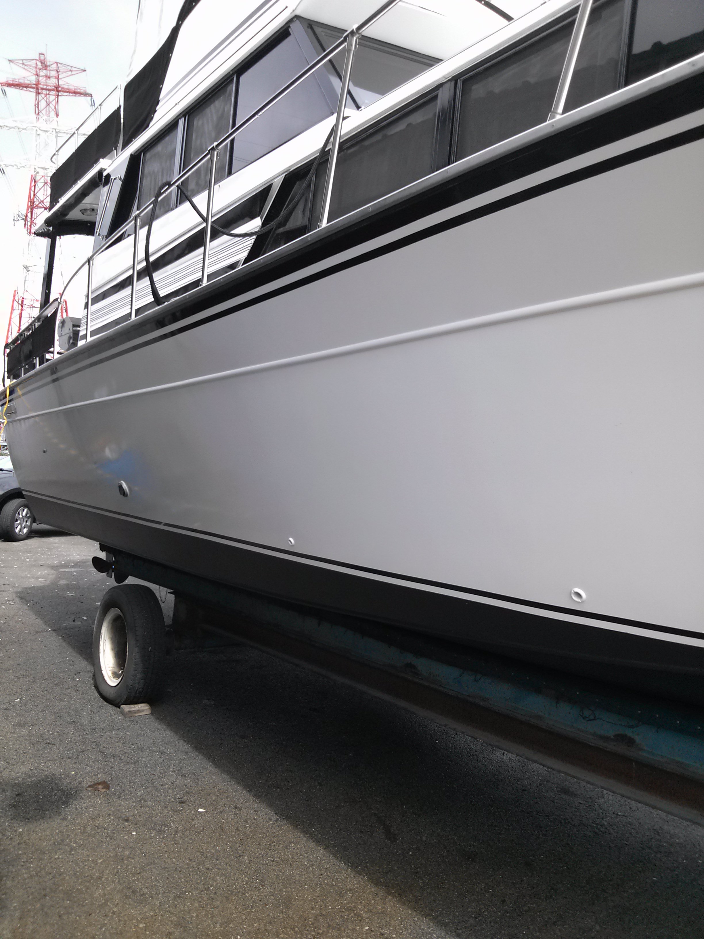

Awlgrip , Imron. I would consider "professional " Both are 2 part. Meaning you need to know what your doing. Both will give you a very hard finish. The interlux is a single. Softer finish. I used the Awlgrip system when I painted mine. "Butt" I had access to a paint booth that the boat would fit into. The finish on mine is 5 years old, looks like it was painted last week. Very happy. "Butt" I had close to 6,000 in materials when I as done. At the same time I seen another Marinette being painted out side with brushes and rollers. using interlux. When they were finished it look beautiful. looked like it was sprayed. "Butt" 3 years later it had lost its shine. Awlgrip, Imron you do not buff. You wash it only. No wax. If you have the time ,and place ,and equipment I would use Awlgrip. If your just wanting to freshen it up. Role , tip the interlux. "Dont" put 2 part paint over 1 part. It will lift. To use 2 part you will have to go to bear alunimum and start over. Joe, Here are some pics. The first was Nov 2012. I painted the boat in the winter or 12/13 .Put it back in in spring of 2013. Pulled it out in Aug 0f 2016 , second pic, to clean bottom ,and fresh coat of bottom paint .
Joe
Posts: 74
Re: Topside Paint

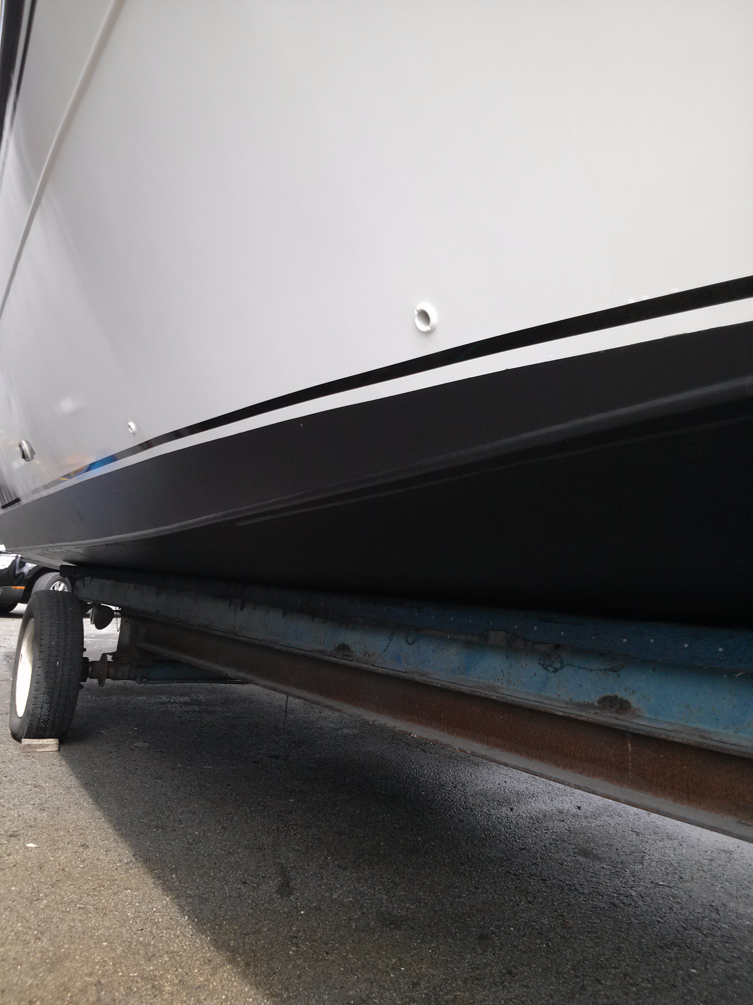

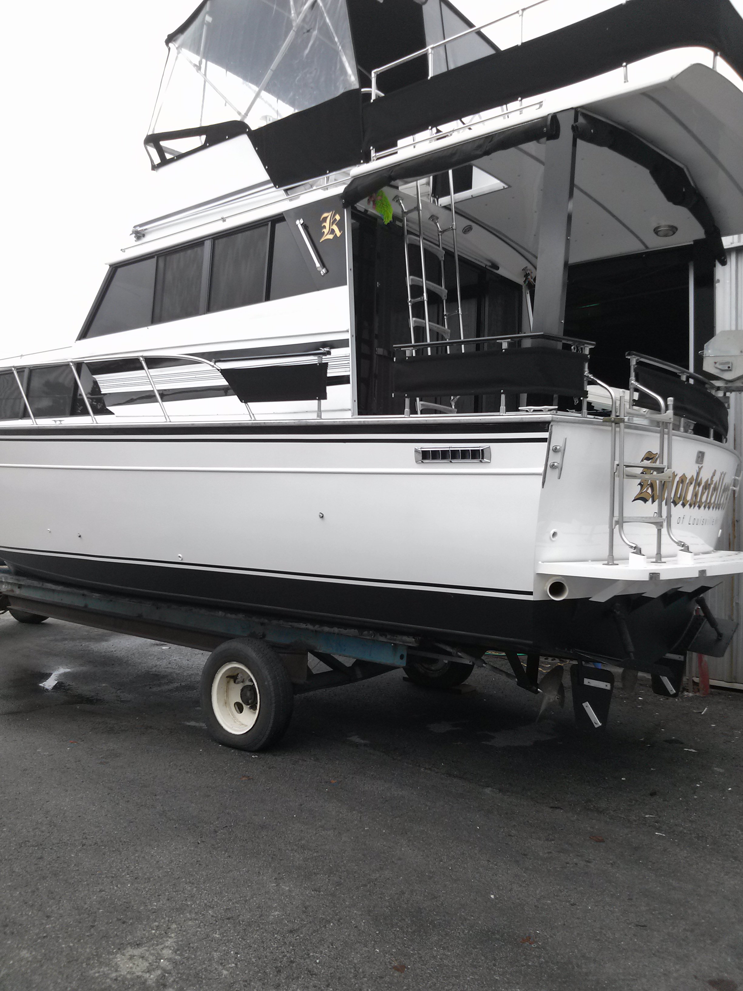

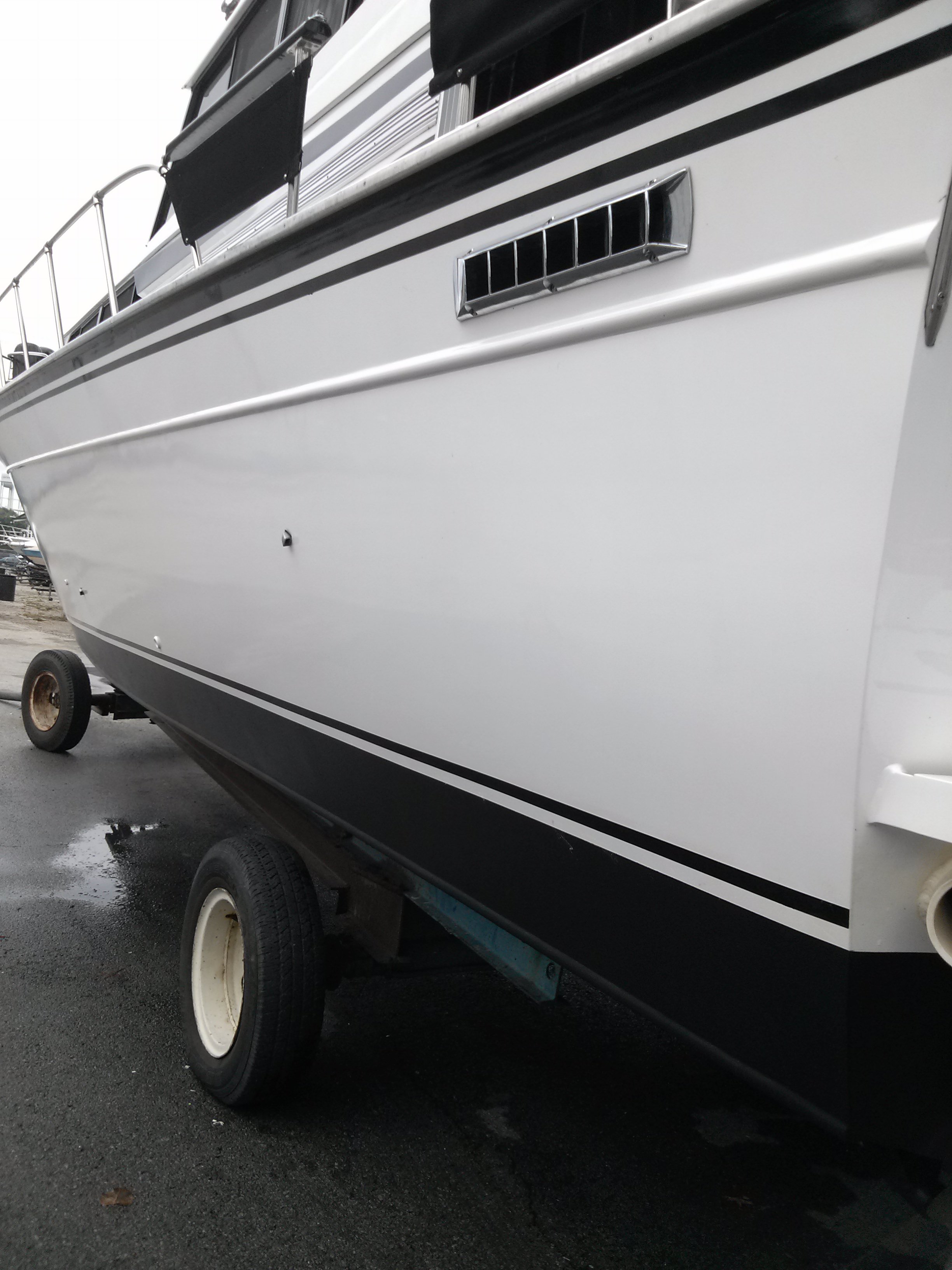

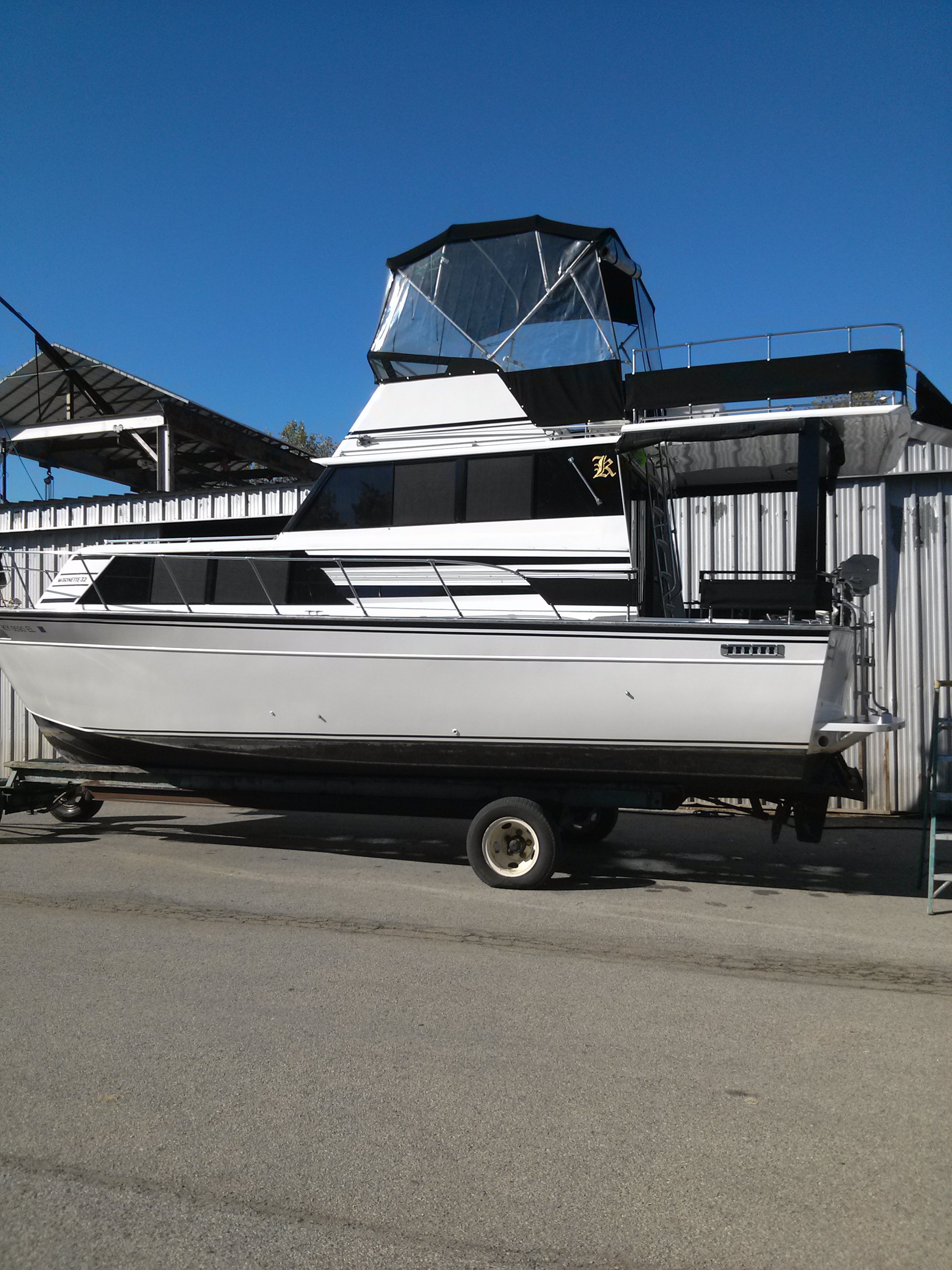

Postby Joe » Sun Mar 25, 2018 9:58 am
This is after 3 1/2 years sitting in the marina. In the water the whole time. No buffing, No wax. Just Awlgrip boat soap only. Very happy.
