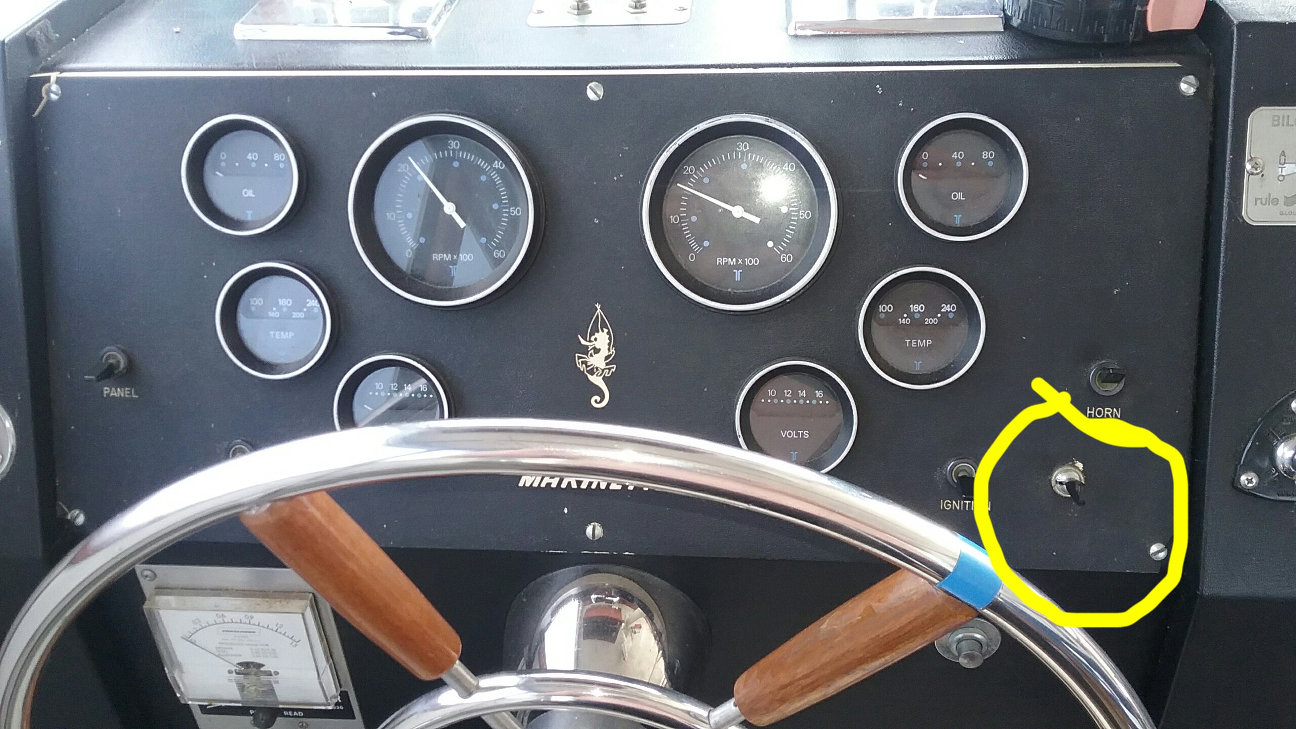

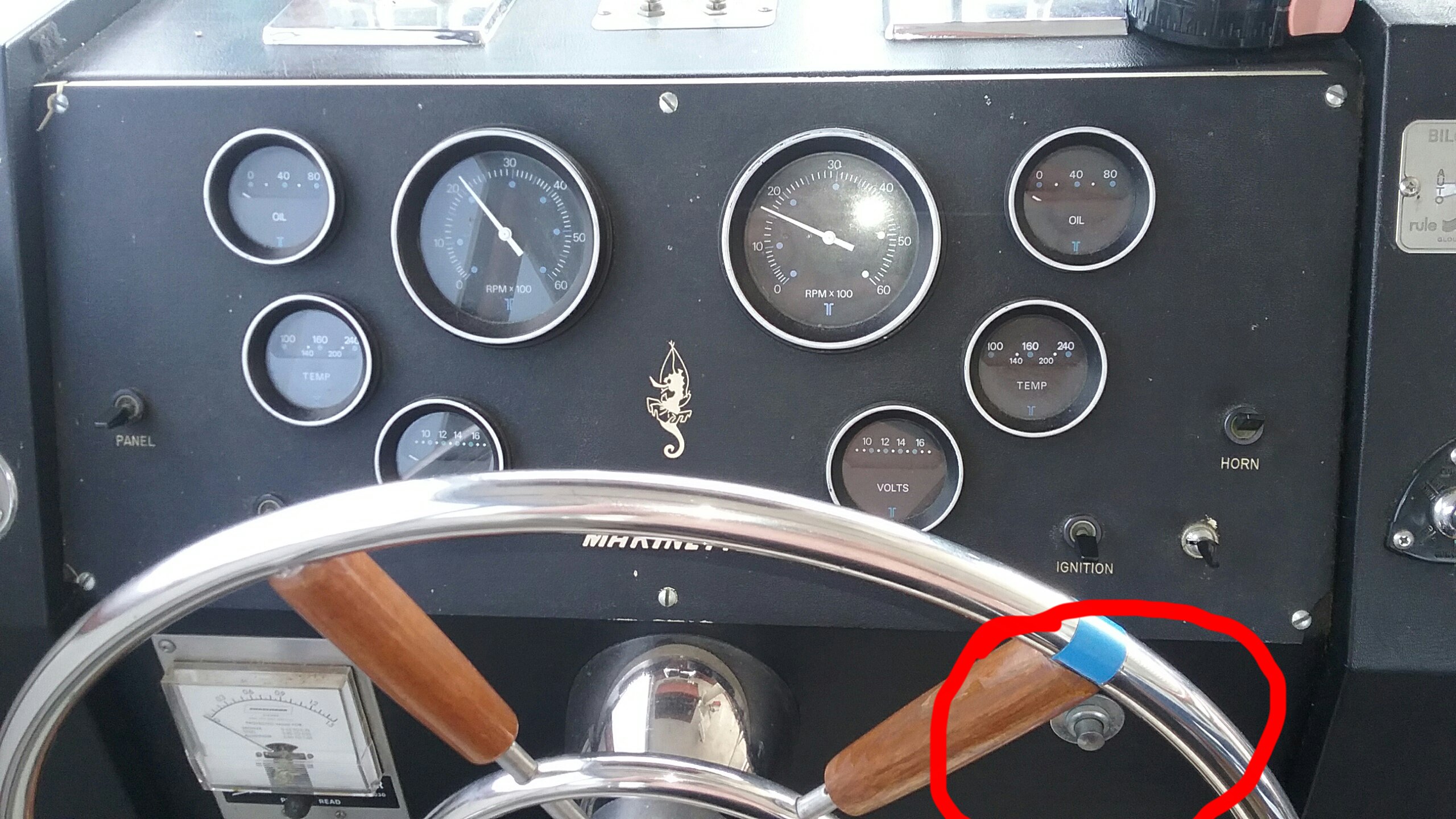

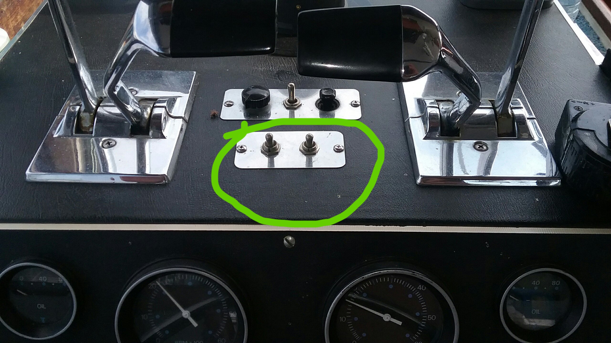

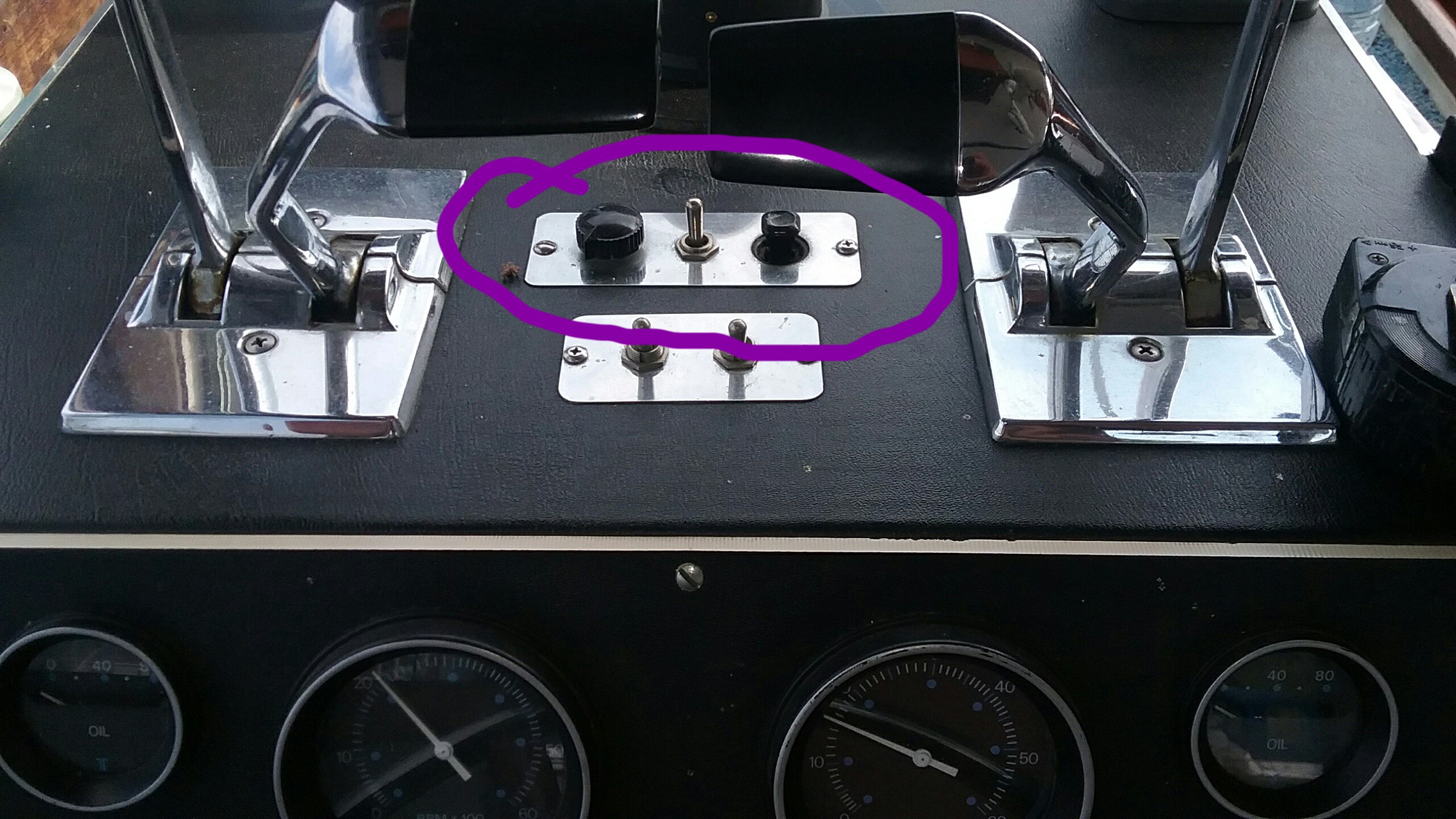

Hello folks. New fella here who just bought his 1st BigM . She's a 1978 32' sedan fb with twin 318s. I have her running halfway decent and am getting ready to actually leave the dock. There are a few buttons/switches at the helm that I am unsure of their function. Before I get myself in too much trouble, can someone please tell me what they do? Thanks much and I promise to have more simple/silly questions real soon.
Momentary push button

The first one...red circle...is easiest. It appears to be the parallel switch that ties both battery banks together. The main bank is on starboard side and the stbd engine gets a bit more juice when you start just as matter of course. The port doesn't get the same jolt, so if you hold the button in when you start the port side, it gets some extra power.
And, because the stbd bank usually powers other shipboard equipment such as the fridge and, I think, lights, it may need a little extra help getting the stbd engine going.
The others are more mysterious. The second appears to be something the PO installed and you may be able to reach out and find out what it does. The ones in the middle appear to be trim tab controls. If the boat is out of the water, it's pretty easy to confirm that. Otherwise, a helper and pretty clear water will help you confirm that.
Wait -- I take back that trim tab referfence: One of the shots shows what appears to be tab control peeking out on the right side. I'll now guess spotlight control.
I noticed that you had the common problem of the corners of the faceplate cracking. Try a little epoxy or superglue in there and also put a nylon washer under the retaining screw to spread the pressure over a wider surface.

Picture 4 with the purple circle is the spot light control. You can see and hear the trim tabs work if you look, even in the water. Underway you will feel the trim change. Good luck, Ed

Green circle - toggles in the middle control the spot light and movement - UP the flybridge has control - Back the lower helm has the control. The other control is , left to right-
speed of travel, spot/flood light/off and directional control of the light.
Not for trim tabs. The other toggle is a PO add mine started the original generator.
