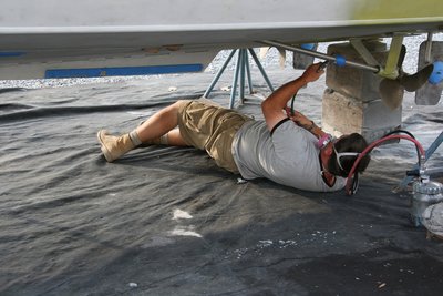

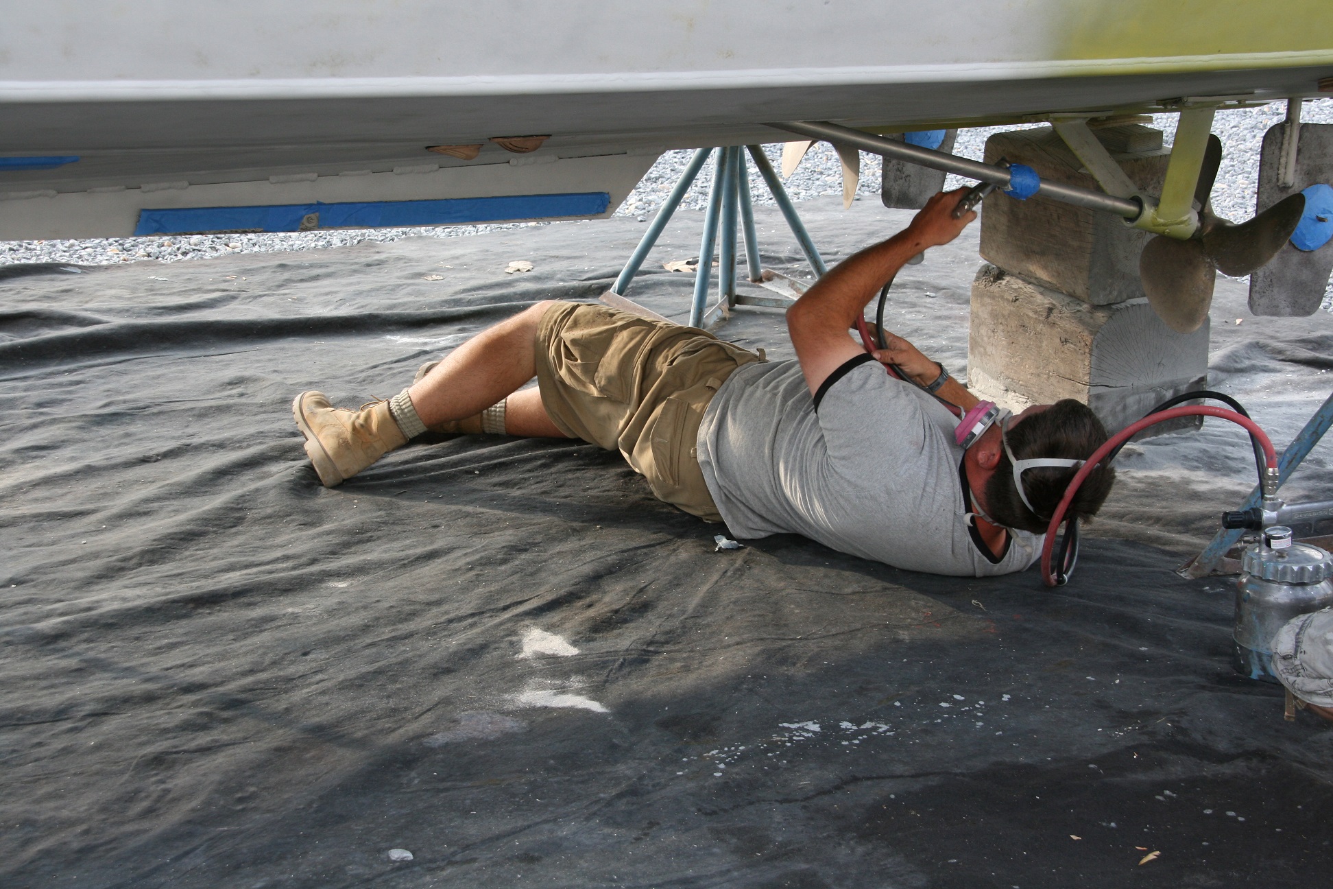

Postby jralbert » Thu May 18, 2017 10:27 pm
Here's a pix when I had the bottom blasted and recoated. the anode is covered in tape so it wouldn't get painted.
Keel anodes are attached to the horizontal (essentially level) portion of the keel, a little forward of amidships. They are thru bolted using stainless bolts. That is through a hole drilled in the keel and the anodes. The keel is scraped clean so the anodes make good contact with the keel. Although some put a stainless washer on the bolt between the zinc and the keel. I forget why.
Hope the photo helps
