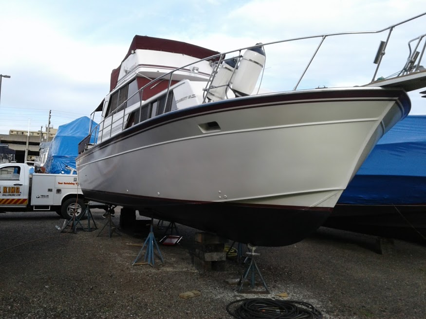

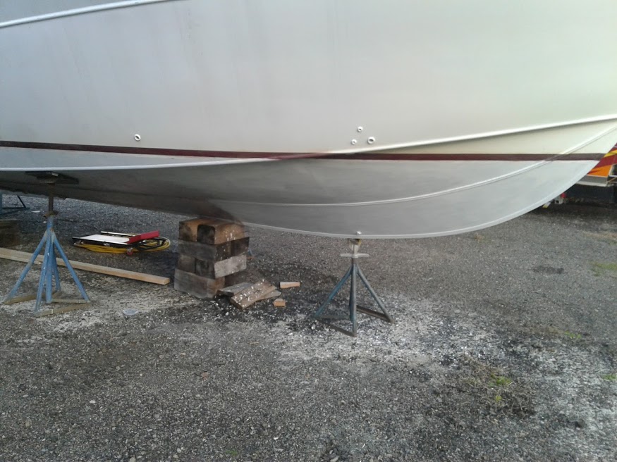

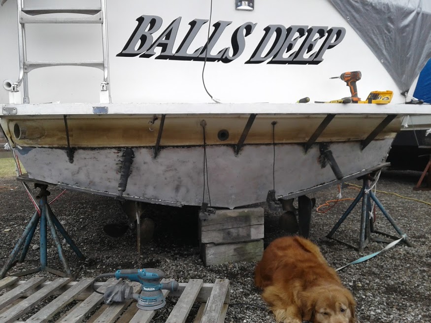

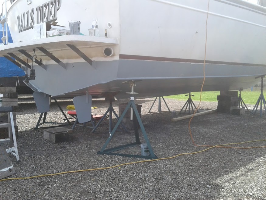

Last years project wow was this fun :lol:

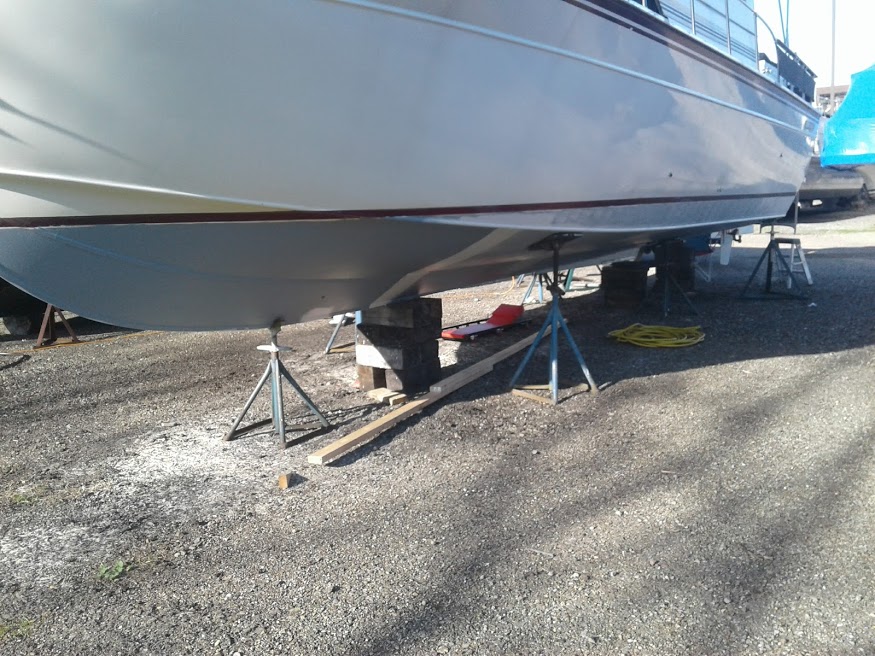

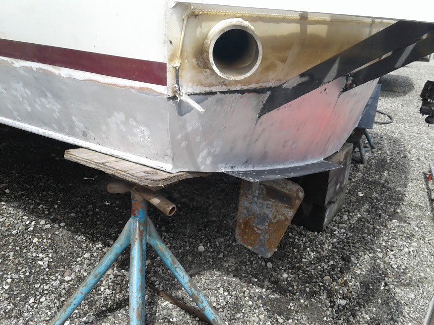

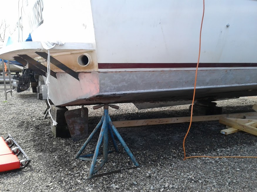

Stripped with pressure washer 4000psi and a month or so with a 5" orbital sander.
I also spot sand blasted corrosion and all the welds.
Chemical metal eched
4 coats of interlux 2000e (alternating colors)
2 coats Trulux 33 (will not use again)

Postby ironball » Fri Feb 02, 2018 1:58 pm

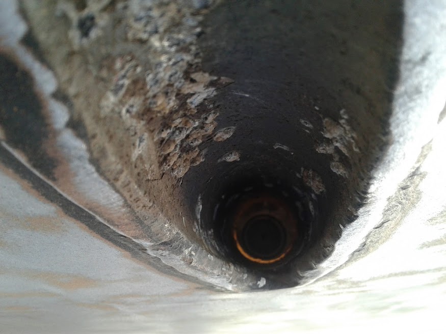

Pitting was everywhere but no deeper than 3 mil or so only filled a couple of spots

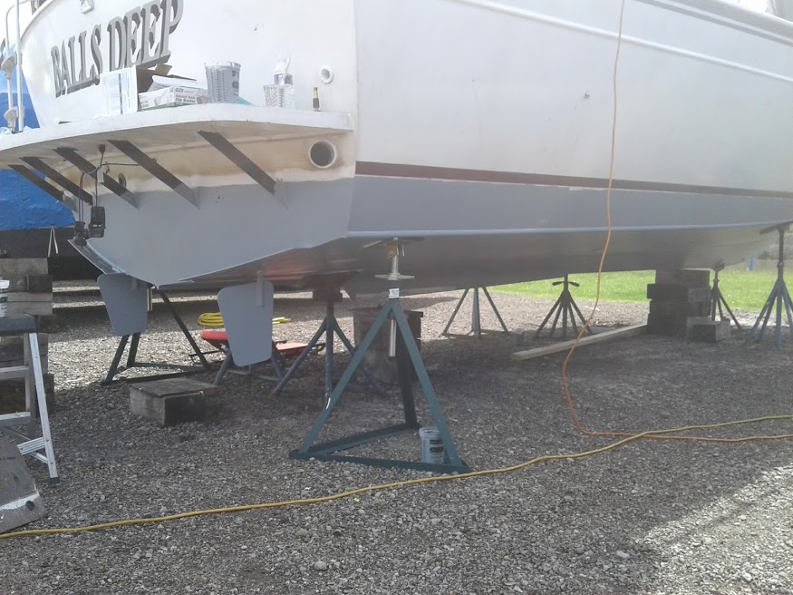

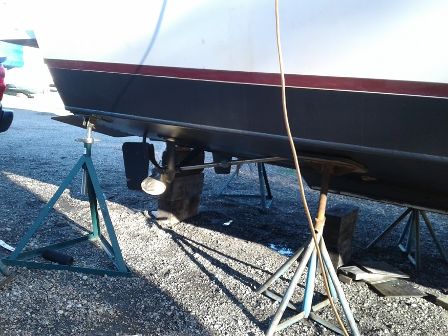

Postby ironball » Fri Feb 02, 2018 2:04 pm

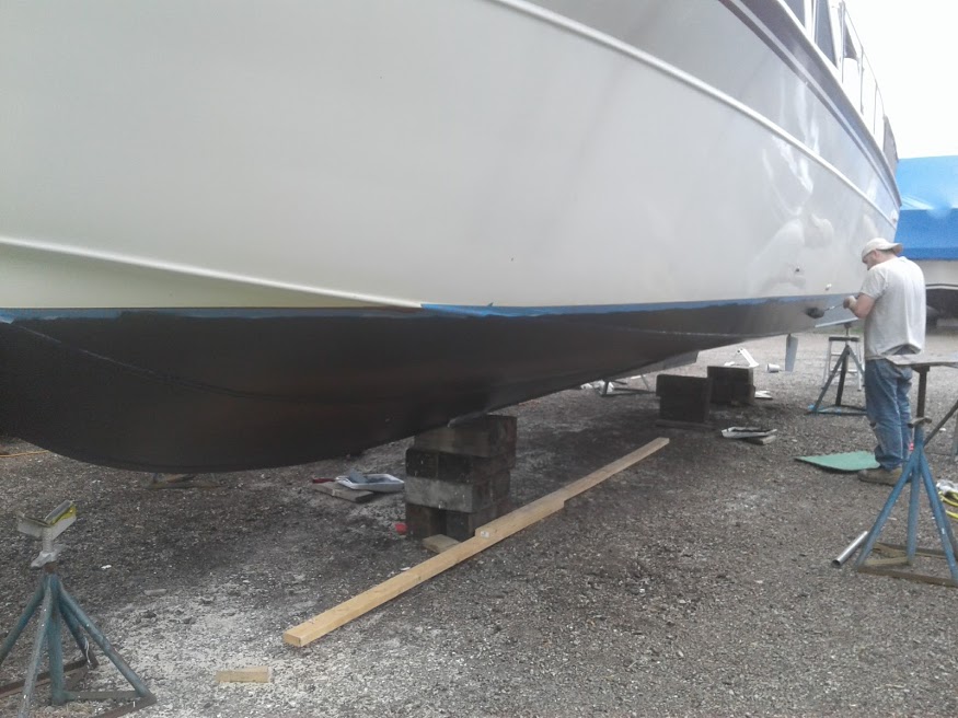

painting begins....... :D :D :D :D

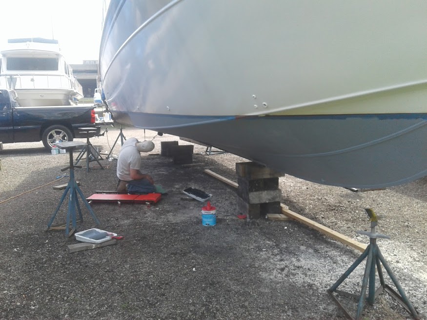

Postby ironball » Fri Feb 02, 2018 2:12 pm

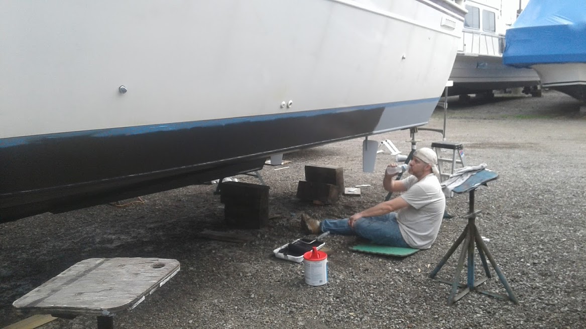

Had to call for help for coat 4 and 5 as they went on tacky for chemical bond. Thanks for my buddy Kenny (in photos) was a huge help.

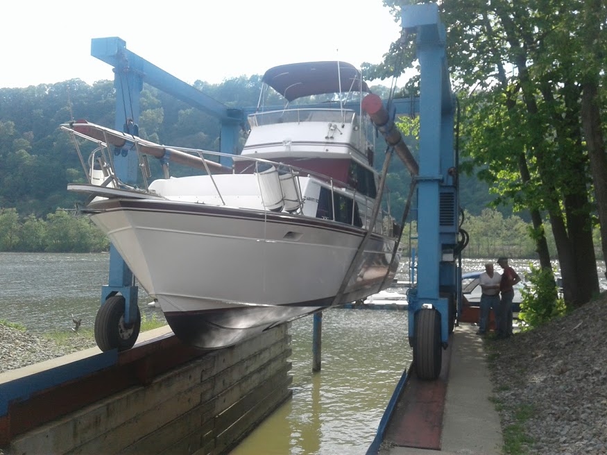

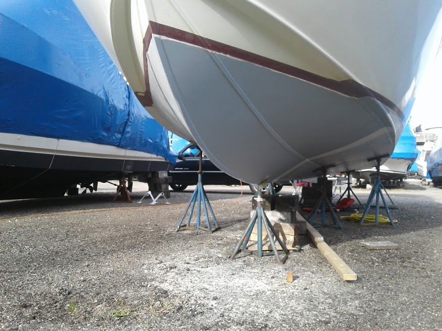

After many hours and 6 coats of paint finally splash day :D :D :D :D :D :D :D
