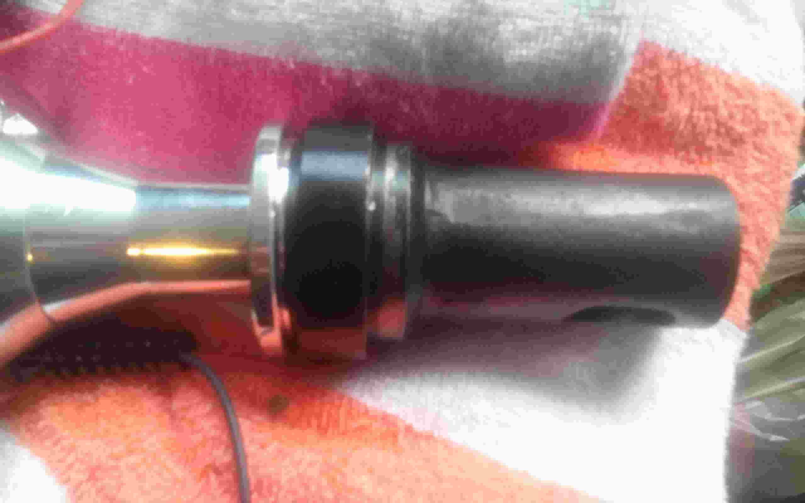

Here's what that sleeve looks like. The distributor shaft has to be a bit longer, I think, to use it.

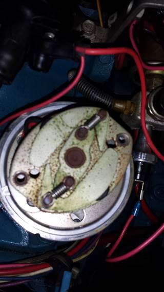

Here is a picture of my STB Dist. 3rd season. There has been some minor corrosion but easy to control. Great access to advance weights and springs. I clean with spray lube and lube pivot pins. Boat runs great and I kept the org. spring setup which came on the Dist. I tried other curves but did not notice much difference. Worked with Rodger and he is great to work with. Very helpful.

Does not look like your sleeve is seated all the way up against the collar?

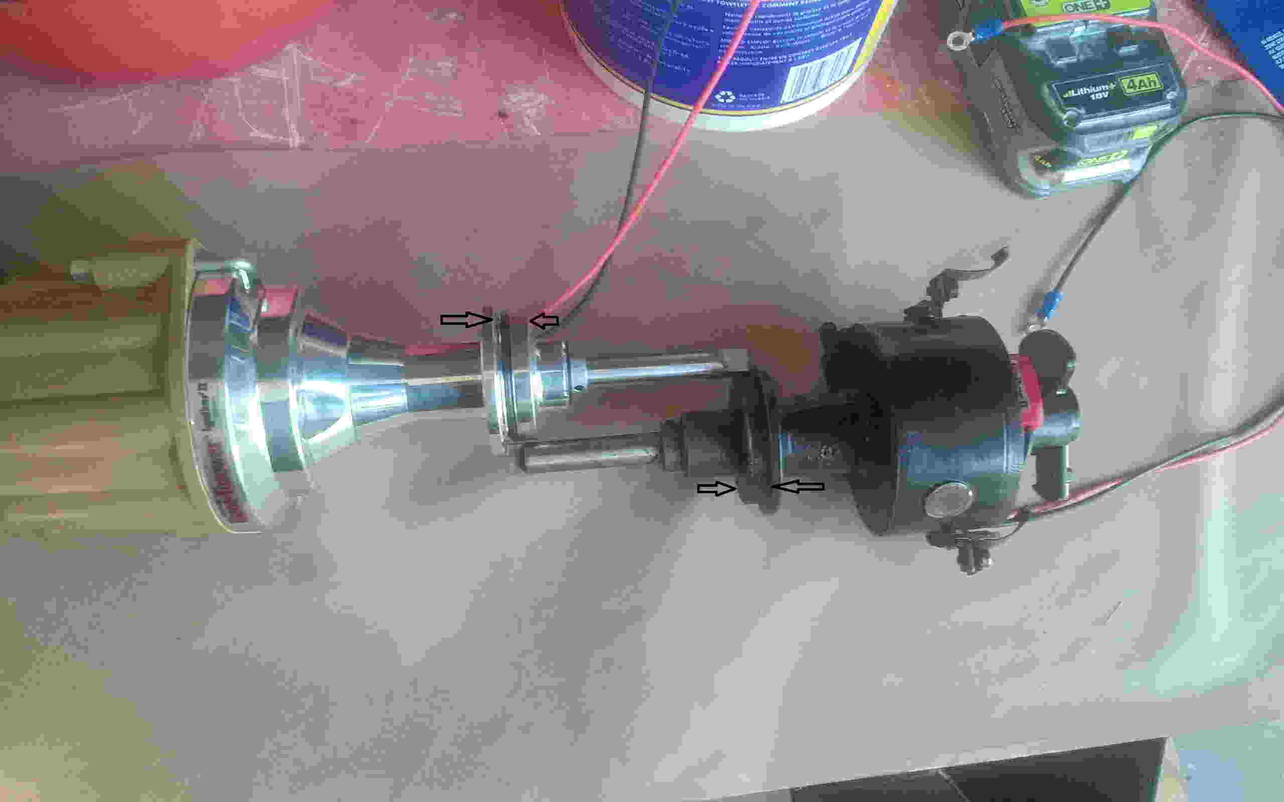

I'm making a print for them now. I find it hard to believe they have ran into as they say 3rd reverse rotation engine application. I have a friend with twins one standard and one counter and have moved the distributor s back and forth and it's really straight forward same sleeve on the counter same prestolite o.e.m.s and another friend with a 67 house boat same setup. The spacer is the easy way to tell if it's standard or counter rotation.

Hope this comes thru ok. As you can see the new dizzy has a .500 step vs the old with a .300.

Your Pertronix unit looks different than mine. (mine has red cap)
Question: Is your OEM Presto. electronic ignition or is a point style.
There is a difference in the dist. between the Point type and the newer Electronic Dist.
Dave

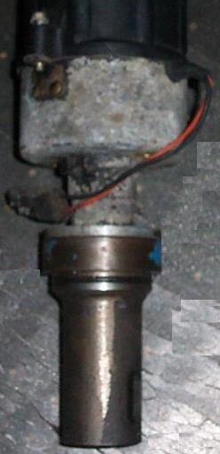

Like usual, I was totally wrong. After a closer look, I see the spacer in question on the stb. engine
