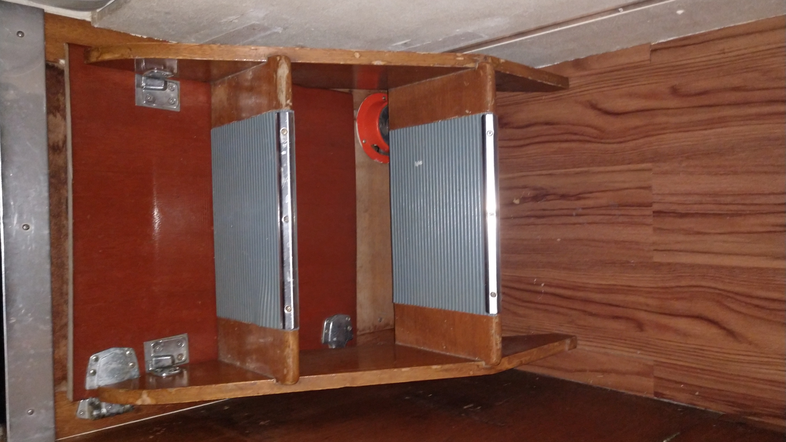

Seef158 years ago I wanted access to the front of the engine. Here was my solution icebox door from an old Chris Craft and steps. The panel will come out but doubtful it will be usable again. Thad

This is also how I get to the from of my single engine Sportsman

That photo reminds me of Diver Dan's 32 footer with big block Chevies installed.
