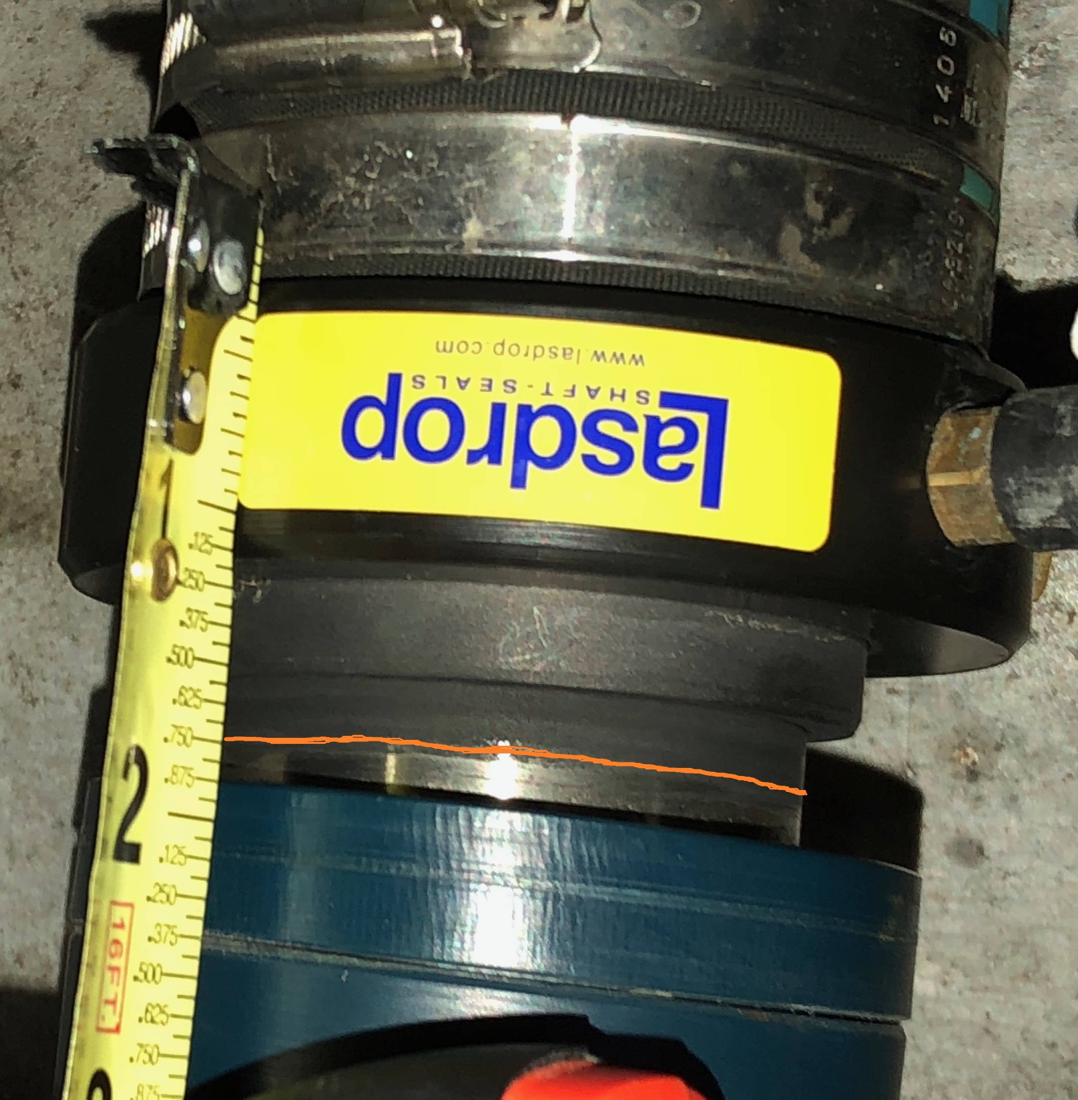

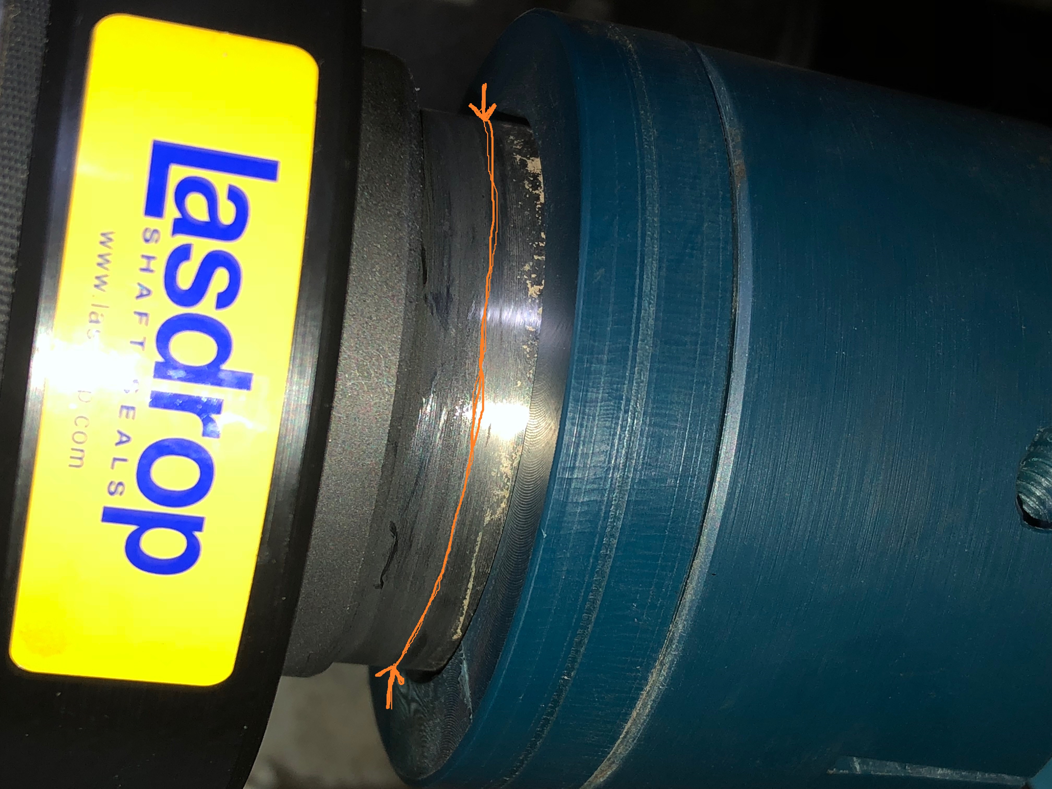

Here are a couple of pics showing how about how much it slipped...
