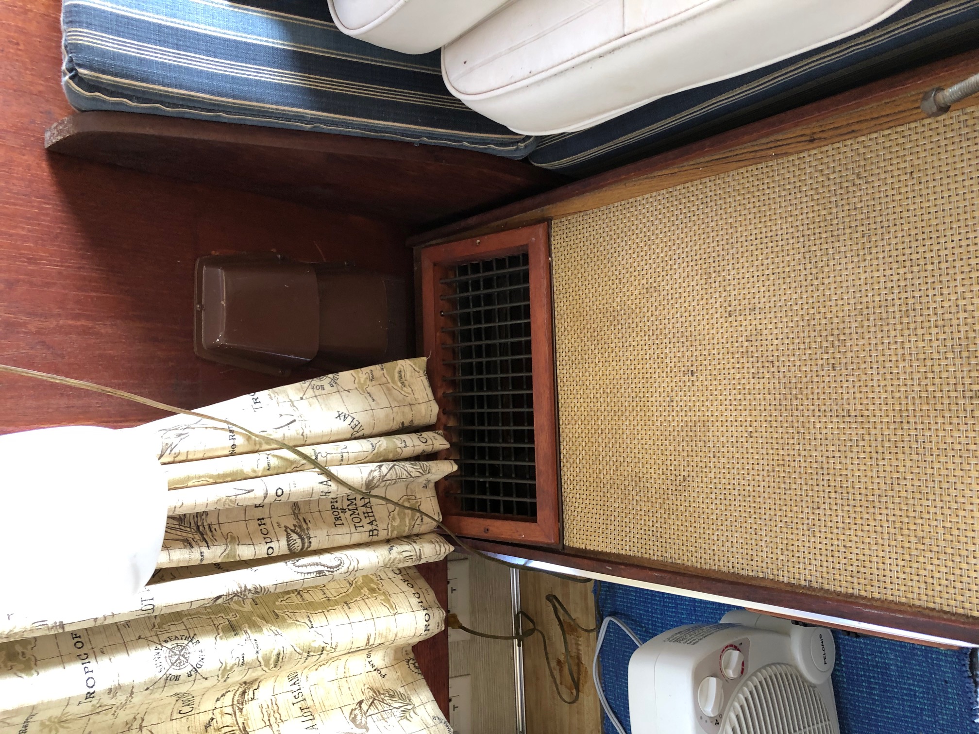

I'm trying the pictures here. Hope it works.
The first pic is the placement of the vent on the counter between the couch and stove.

Thanks for the pictures. I like how they installed that as it keeps that one area for storage. Also the way the vents are routed, it probably forces more air to the salon. Thanks it gives me something to think about
