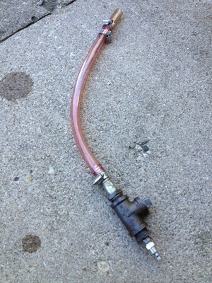

Post by pbaker32s »
I have saved many cables with this homemade cable Luber ,you should be able to see in the picture what you would need from the hardware store .you clamp the hose onto the cable end ,I usually put sea foam or kroil in the Reservoir first pass and put air pressure to it .I usually start out low make sure I have no leaks and then steadily increase the pressure. I have had up to 90 psi forcing sludge thru the cables,sometimes it takes a while to work all the degreaser or oil through the cable .I have Had some take all day.usually the last pass I put synthetic transmission oil through it. I have taken a seized cable to smooth as butter. Never put grease on the cables. It’s easier with the cable off, If that is not possible make sure you have a trash bag or something under the opposite end to not make a mess
