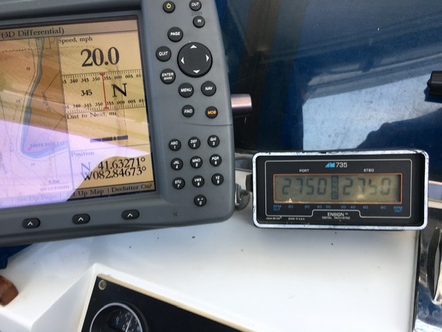

Re: 318/392 Stroker Motors
What props are you using ? I have 16x16 3 blades as came factory. I can never remember the speeds /rpm‘s so I took some pictures this weekend . 7 people aboard full tanks top on.
I have seen 34 mph. Around 4200 rpm’s
