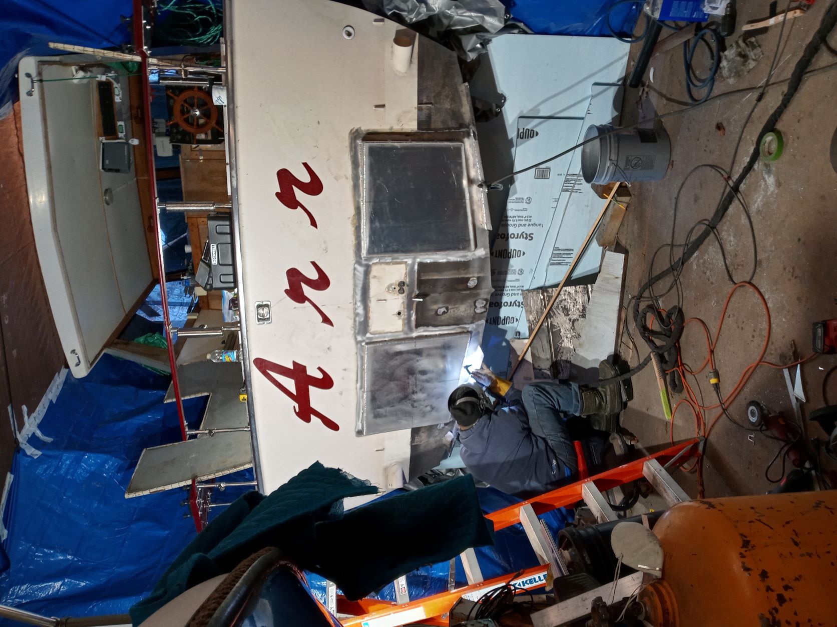

TinLizzy
- Posts: 270
Re: A little crazy?
Welding in the first boxes.

TinLizzy
- Posts: 270
Re: A little crazy?
My measurements were off when the boxes were welded in, resulting in two non parallel planes. So, cut it all out, and rethink the design.
