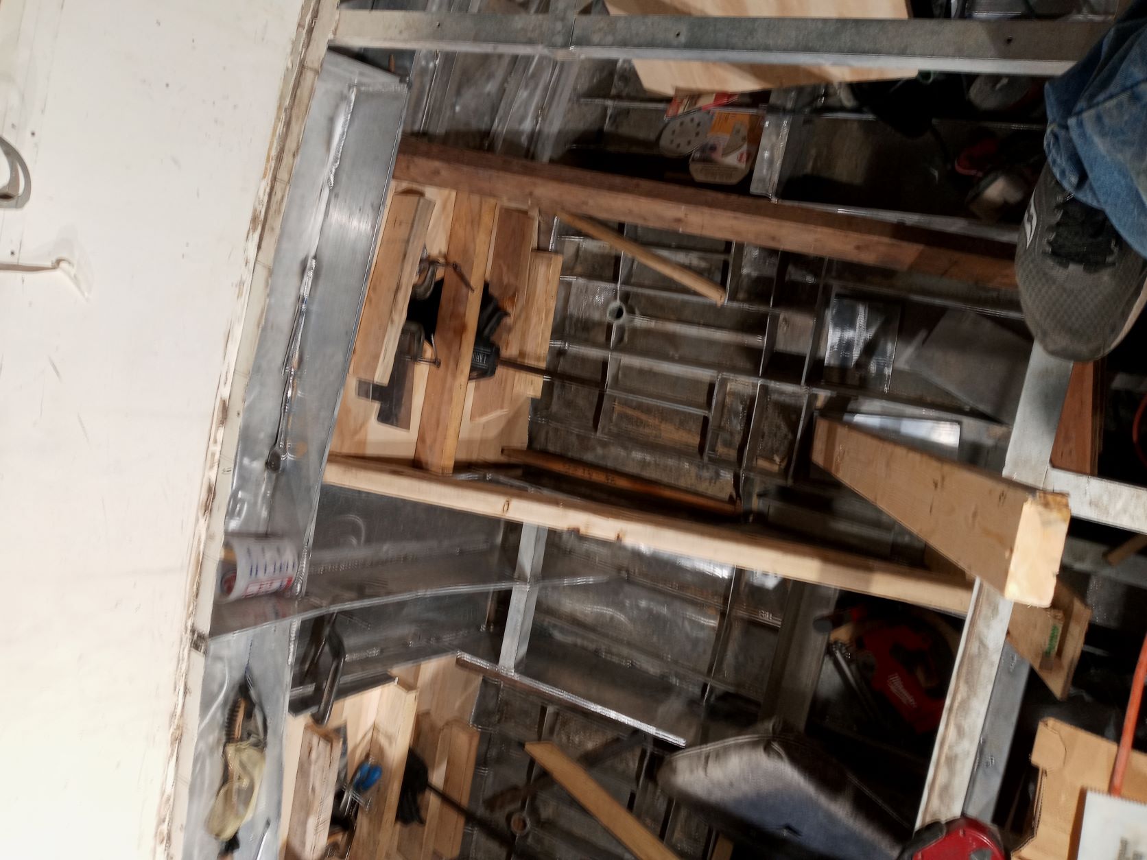

TinLizzy
Posts: 270
Re: A little crazy?
Post by TinLizzy »
Mocking up engine fitment for motor mounts.

Rodney
Posts: 911
Re: A little crazy?
Appears to be a beautiful, professional install. Question (too late, of course, but): may it be aft-heavy? How are you balancing it?
TinLizzy
Posts: 270
Re: A little crazy?
Post by TinLizzy »
Joel, the fuel tanks went right up to the forward bulkhead, parallel to it. This helped a little, also I didn't replace the old 12 gallon water heater at this point. Replaced old rotten holding tank wit a smaller plastic one, mounted as far forward as I could.

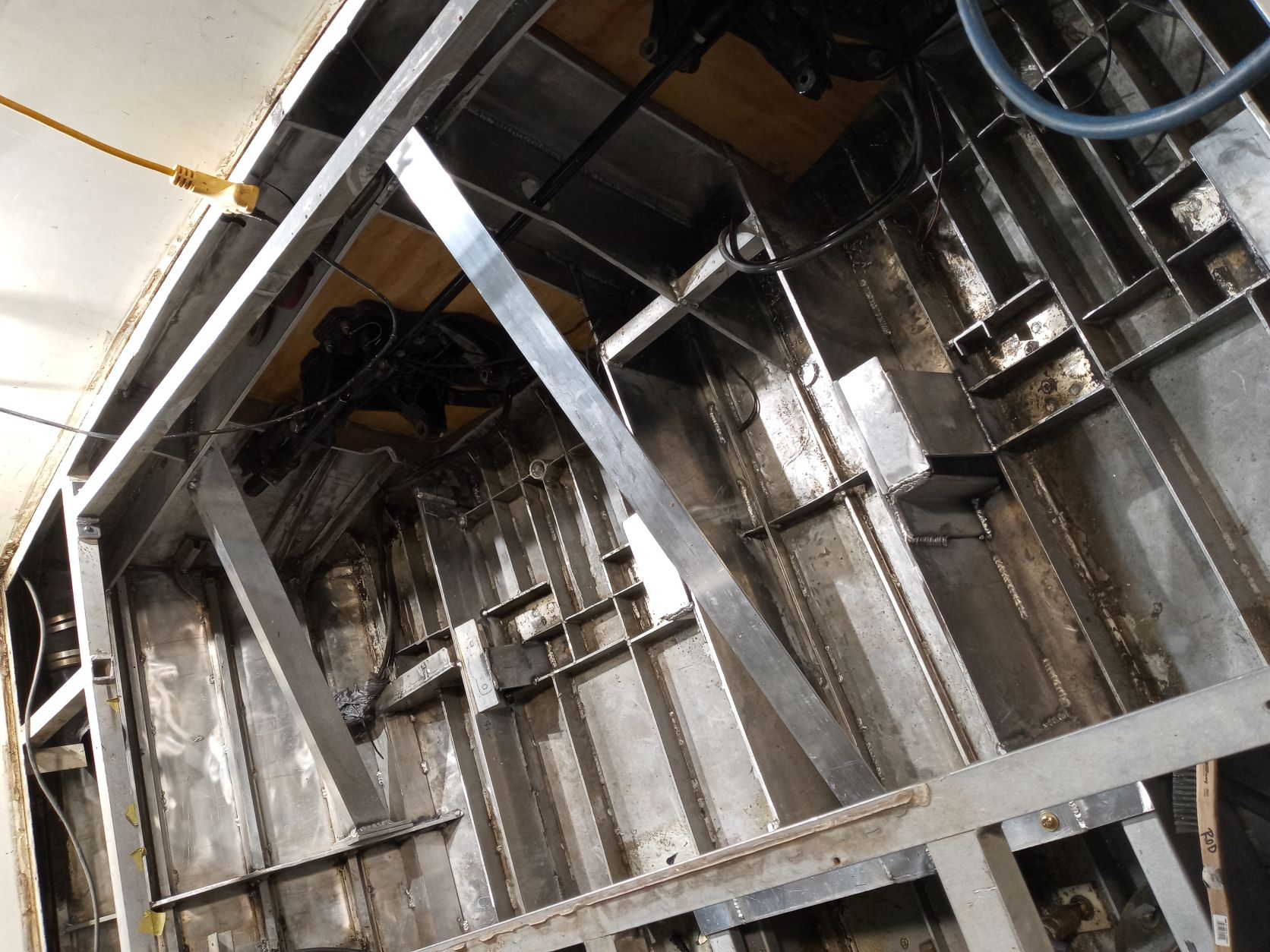

TinLizzy
Posts: 270
Re: A little crazy?
Post by TinLizzy »
Gusseting fitment before final engine install. They will be anchored with multiple 1/2" grade 8 bolts, only a few are showing during mock up.
Rodney
Posts: 911
Re: A little crazy?
Understand. One last question based on last set of pix. Bottom detail isn't clear... did you provide for weep holes between the little compartments that will be on the floor under the engines?
