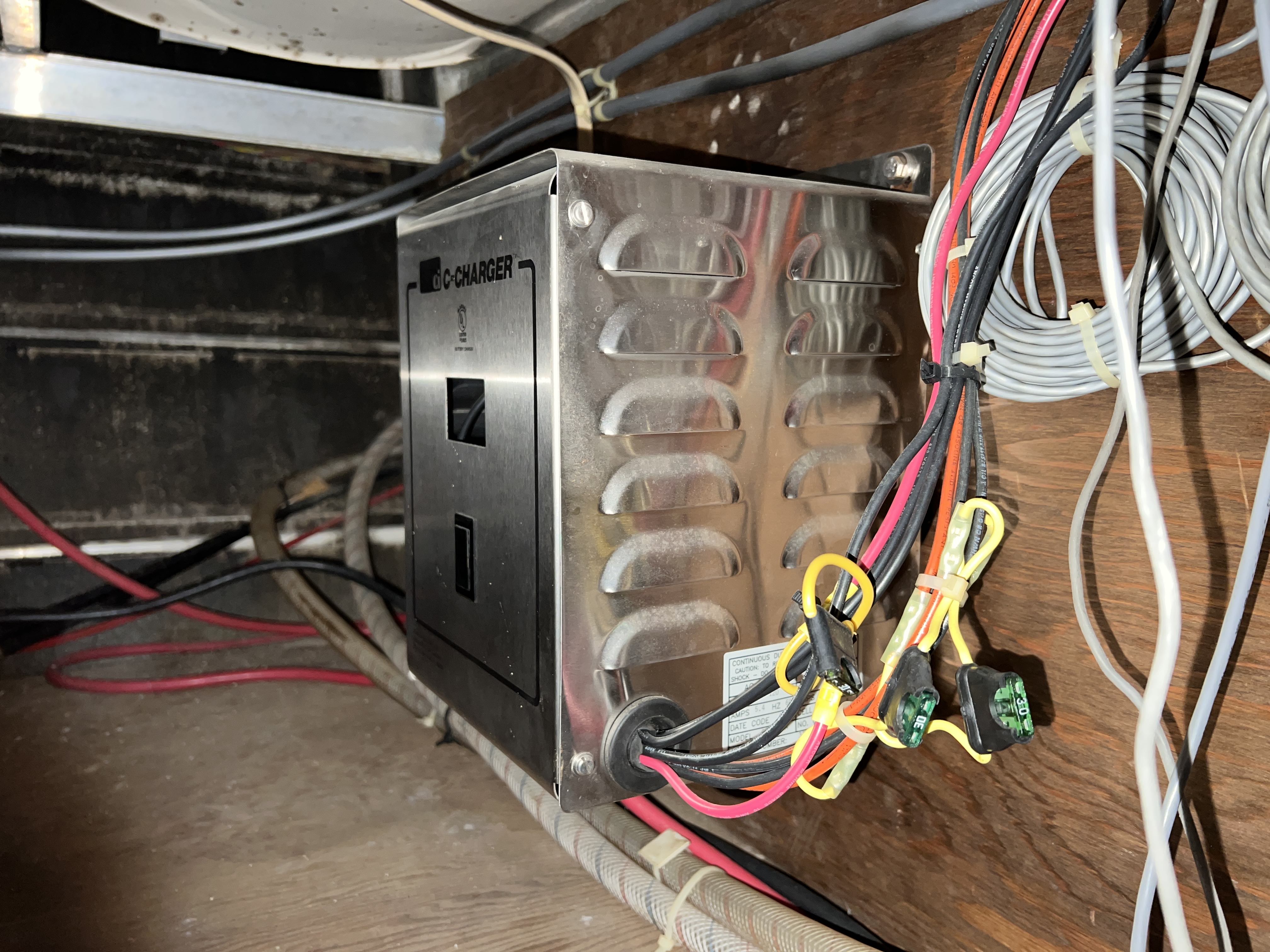

Haven't started flipping those switches, but I did find the problem!! First, to answer your question, she has two "marine" 12 volt batteries and a third 12v battery that's more of an automotive size. Not sure what role that one is playing.
I investigated the battery charger through the hatch under the stairs and sure enough an inline 30 amp fuse was out. As soon as I got a new fuse in there (temporarily stolen from my truck's rear power windows, lol), things started coming back on as they should - at least as far as I knew it before the problem showed up. After a day or two of charging, the depleted starboard battery is now showing 12-13v and and I have cabin lights, radio, auto function on the bilge pumps, among other things... but most importantly I have the blower and both ignitions back.

Keep an eye on the charger fuses. Looks like the batteries are newer but one may be bad/failing and causing the charger to pop a fuse. Can you verify battery voltage while trying to crank that engine that wont start? I'd bet either the starting solenoid or battery is bad. Generally those are the 2 main issues if a known working engine wont turn over. The starter may also be bad but I'd lean toward the other 2 items first. You can pull the starter and have it tested. If memory serves I had one of my starters tested at Napa auto store many years ago. Might call around and ask before pulling it.
