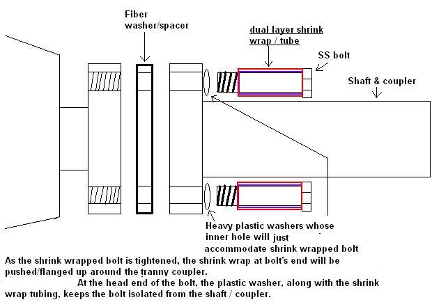

>> coupler passes the bolts through but they screw into the flange. Makes the heat shrink impossible.
Actually, you may be able to do the shrink tube...

yooper wrote:It would be nice if I could order a kit that has all the non-conductive elements in it. Kind of like a gasket set you can buy for an engine.
John Althouse had them but, sadly, I don't think he can supply for a while at least. Meanwhile, the diagram above should be good guidance for everyone.
