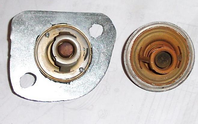

Dave, the old boats did use the $100 thermostats. They are in the 4th column.
Re: Engine Over Heating
You can also make a FJ CHeapo t-stat from a standard, low cost, smaller diameter t-stat.
Here's what it looks like. Use a stainless plate.
PS: This design also compensates for rotted out intake manifolds that let water slip by, extending the warm up period.
That's what I'm talking about. Thanks this is an easy cheaper solution.
