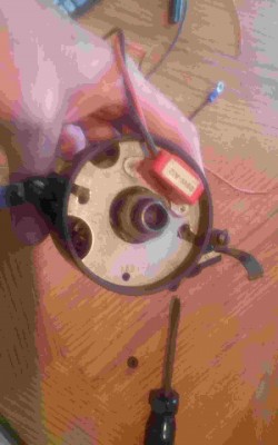

jmonday
Posts: 154
Joined: Thu Jul 31, 2014 2:01 pm
Re: Pertronix D241801 install
Post by jmonday »
That's really odd my ignitor 2 that came with my boat was cut like the photo. I ordered the same part number 1581 and had to cut it the same way. My thing that spins round and make fire 8 times per revolution ( assie for dizzy) has been sent to pertronix maybe they can solve the mystery.
