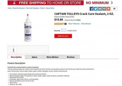

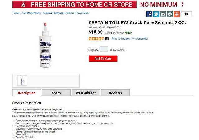

West Marine (and perhaps others) sell a thin, white liquid that gets into cracks and sets up to seal them. I believe the name is Capt Tolley's Crack Sealer. It's for very narrow cracks, not wide ones.

Right! That Captain Tolley stuff works great. Sealed mine years ago and haven't seen a leak yet.

this is it

That's it--and it's worth every penny. And that bottle will is all you'll need for the life of the boat.
