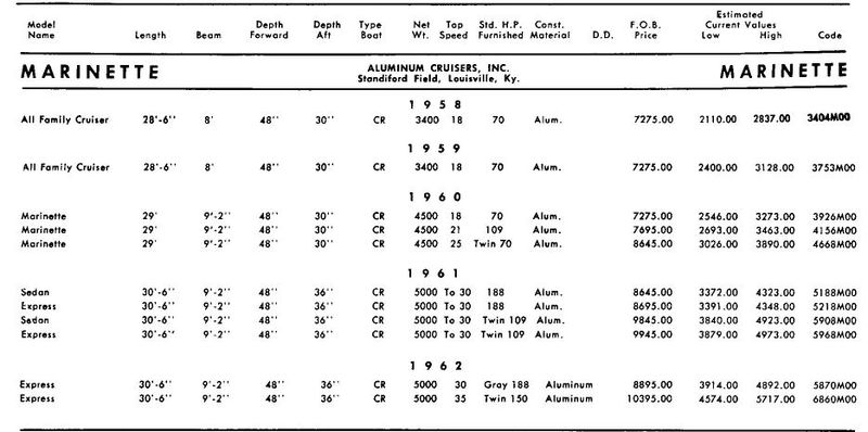

"I think the boat likely came with a Grey Marine 190 hp 6 cyl. I would like to be able to use the boat on long trips (loop?) I would like it to be good on gas, but also be able to go fast enought to plane off...if the is possible?"
That is a tall order and unlikely on a Family Cruiser. While not as much beam as later M's the Family Cruiser was better suited as a semi-planning hull and most did have Grey 6's. They cruised around 9 MPH and you might expect 1.5-2.0 MPG. With the narrower beam they tended to plow when loaded with passengers and all the cruising gear.

I'm pretty sure these only came with a 4 cylinder, twin 4 cylinder or 6 cylinder.
