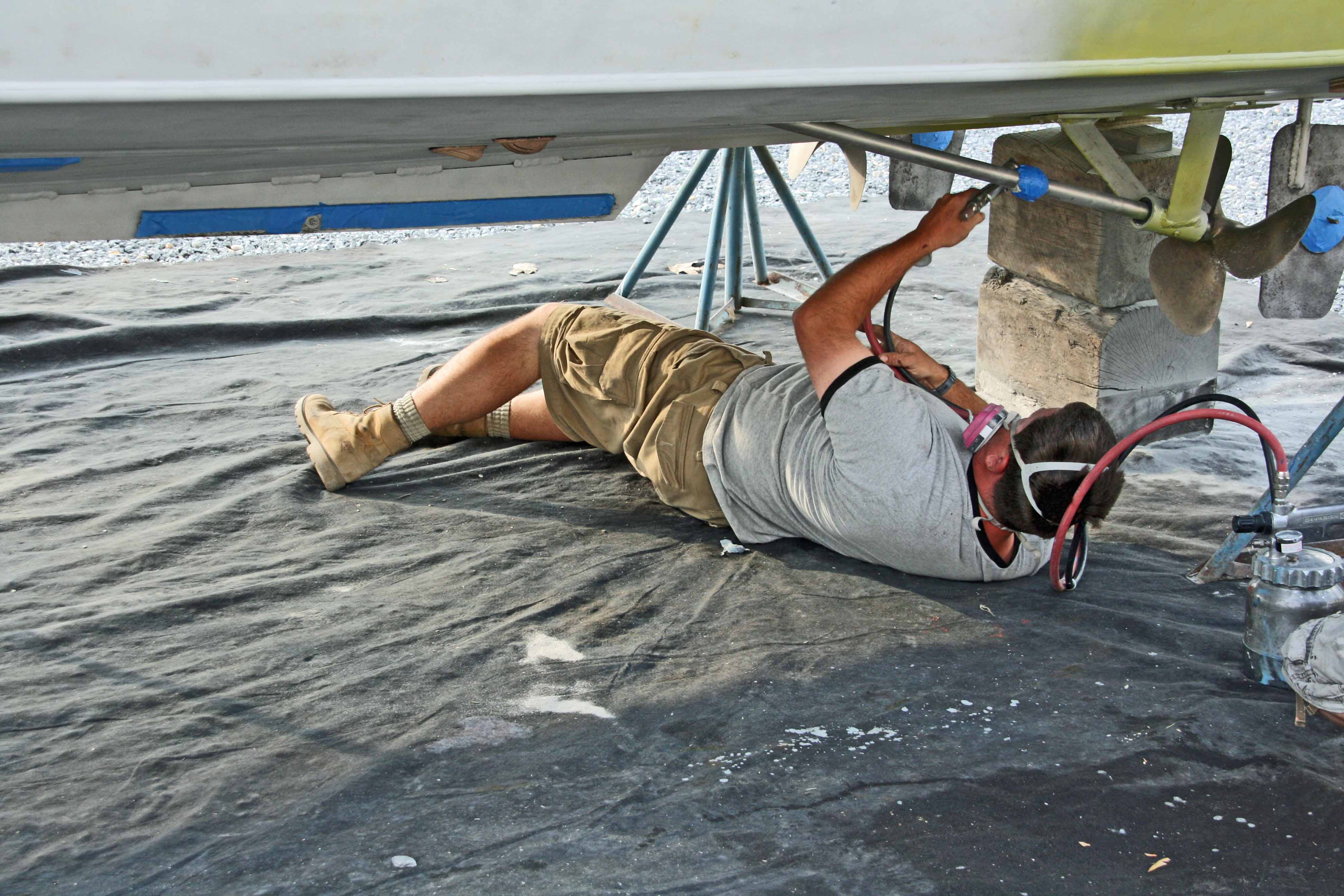

Picture, please and we can clear this up in a flash. But from your desciption, it sounds like it sure is a part of the boat. I am attaching a photo of my former '32 showing the last few feet of the "fin" (a keel stabilizer integral to Marinettes) when I was having the bottom blasted and repainted. It has a piece of blue tape covering the zinc strip over on the left side

No pics at this time. Joels picture shows the fin that my boat has. I'm now convinced it is factory. Yes, the anodes are bolted to it. It is going into very warm salt water. But, the boatyard guy, who has restored a Marinette before, advocates deleting the fin, welding six aluminum plates to the bottom of the hull (two forward, two mid-ship, two low on the transom) and welding sacrificial aluminum anodes to these plate. He says that is the best electrolysis protection to be had.

That is part of the keel, you need it. Factory installed. Clean it up and weld it back on. Easy job and will be done with MIG not TIG. The skin is not very thick so I would not weld plates to the skin to put anodes on. If you were to use the weld on anodes the thick keel would be the easiest place for them. The bolt on ones work well and are easy to do. ONLY use aluminum anodes. All the aluminum anodes are the same alloy. Best place I've found is boatzincs .com Just have the hull clean and bolt on with SS hardware.
