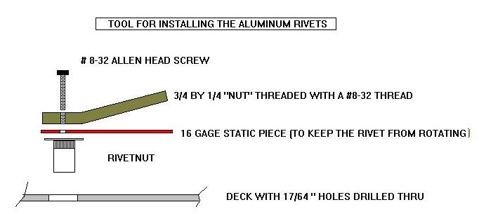

Jeff, I guess I don't understand. Did you have to get to the back side & use an extra nut to smash the threaded rivets?
Roger
Roger Brown
Petersburg, IL
Re: what to do when railing screws are stripped out
Can't find the sketch I made.
Study the right photo. That small piece of metal (4 x 2 inch) with a hole drilled in one end is the "handle". The Allen bolt goes into a nut, then through the "handle", then into the Rivet Nut.
Place the Rivet Nut, handle and bolt assembly in the hole in the deck, hold onto the "handle" so it won't turn and tighten the nut (on the Allen bolt. Sometimes you'll need to also have to stop the Allen bolt from turning until the Rivet Nut starts to seat.)

Jeff,
This the drawing you mentioned?
Railing rivet install process
