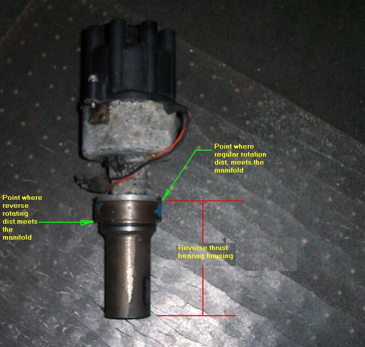

The gears driving the oil pump/ distributor are made to turn them backwards. The RR distributor has a collar around it to absorb the trust loads from the gears since it rotates in the opposite direction. So....you need the RR distributor but not the oil pump (that is the same).

What am I missing here. Distributors are the same. It's the cam that has the gear reverse ground to make the distributor turn the same direction. Since the cam is turning the opposite direction, the collar is used to keep the distributor from riding up.

Yes both distributors are exactly the same .There is no such thing as a reversing distributor for these motors. Just check with Prestolite, holly pertronix, you can call Hurrikain Marine . I checked with all of them , the part # for both distributors is the same. Do not waist your time looking for a reversing distributor, It simply does not exist.

Pull that collar off it is the exact distributor. That collar is not part of that distributor you must reove it and use it on the new distributor.If you can find a part # for this so called reversing distributor please share it .
You can check with every manufacturer the cw and ccw motors use the exact part #. I know I have done my reserch.I have also pulled the distributor off the cw motor and put it on the ccw motor.They are the same!!!!
Again if you can find a part # that is different for a reversing distributor,please share it.I assure you that you will not find one because it does not exist.
Btw the gear on that distributor is exactly the same as the other one.
