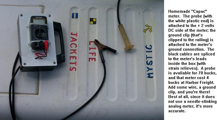

"...Buy or borrow a tester. Adding too much anodal protection can do as much damage and too little...."
Jeff Perry once made a simple, effective tester. Perhaps he can post the how-to here...
Re: Battery ground to hull?
You buy a probe from (I forget--try the internet. about $50.) Next, buy a cheapo ohm meter ($5 from Harbor Freight). I then used a small plastic box to connect the wires together: the + to the probe, with the - to the ground. The ground wire has a clip on the end that goes to a railing post. You then lower the probe into the water, set the meter on the 0 t0 2 volts (or so) scale, and take a reading, with 0.9 volts the optimum.
