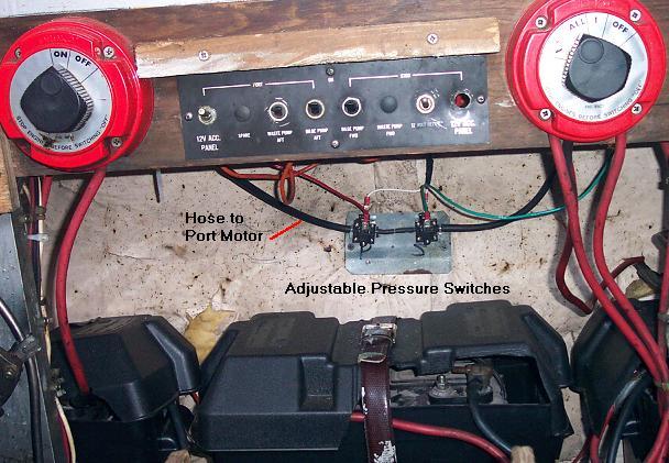

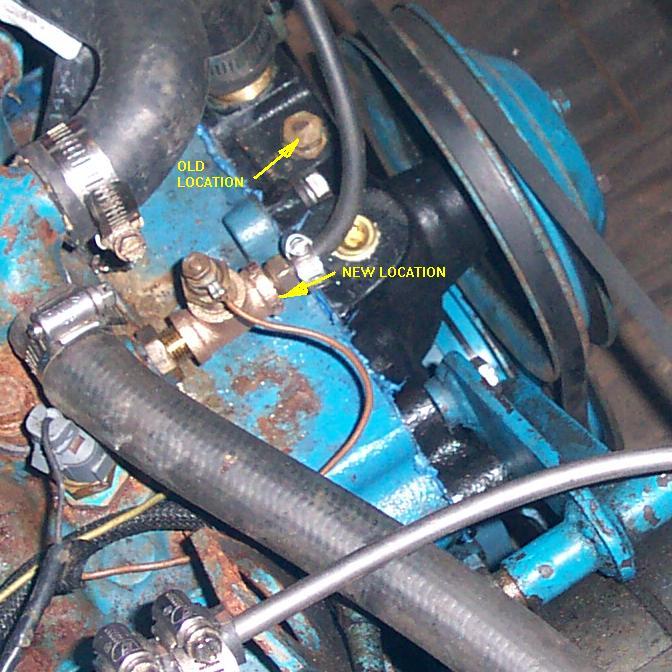

PS: The alarms are adjusted in NEUTRAL at the dock. If you have FWCooling--mine is RWC--you'll need to locate the alarm pressure feeds in a different spot. Note that I located them HIGH as possible to prevent freeze damage in the winter.
