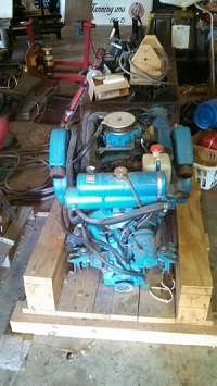

Holland Chrysler b.jpg (40.56 KiB) Viewed 13378 times
Trying to figure out how to add a pic

21 mph is the expected performance for 318 I think... You won't get better for 360 or 440. It's a light boat for a 318. Twins would go faster (I had twin 318's on the Fortunato I). I agree with Jeff, stay with the one 318's. A 360 is the most I'd go, and it's a hard sell.
For me, I would strip the old engine of anything I expect to keep ... immediately and store it. Mostly, I never reuse parts unless I have to... Fresh water cooling, starter, Electronic Ignition, yes, Water pump maybe, carb maybe... etc.
Also have the old and new engine checked.
My questions to the seller ... Is compression OK, tested? How much is the newer engine? Valves Ok? How many hours? IS IT THE SAME ROTATION? Does it come with the Velvet drive? Oil test OK? One that you sample and send it to AMSOIL.
A rebuilt long block swap may be cheaper in the long run. Used engines have no warranty.
