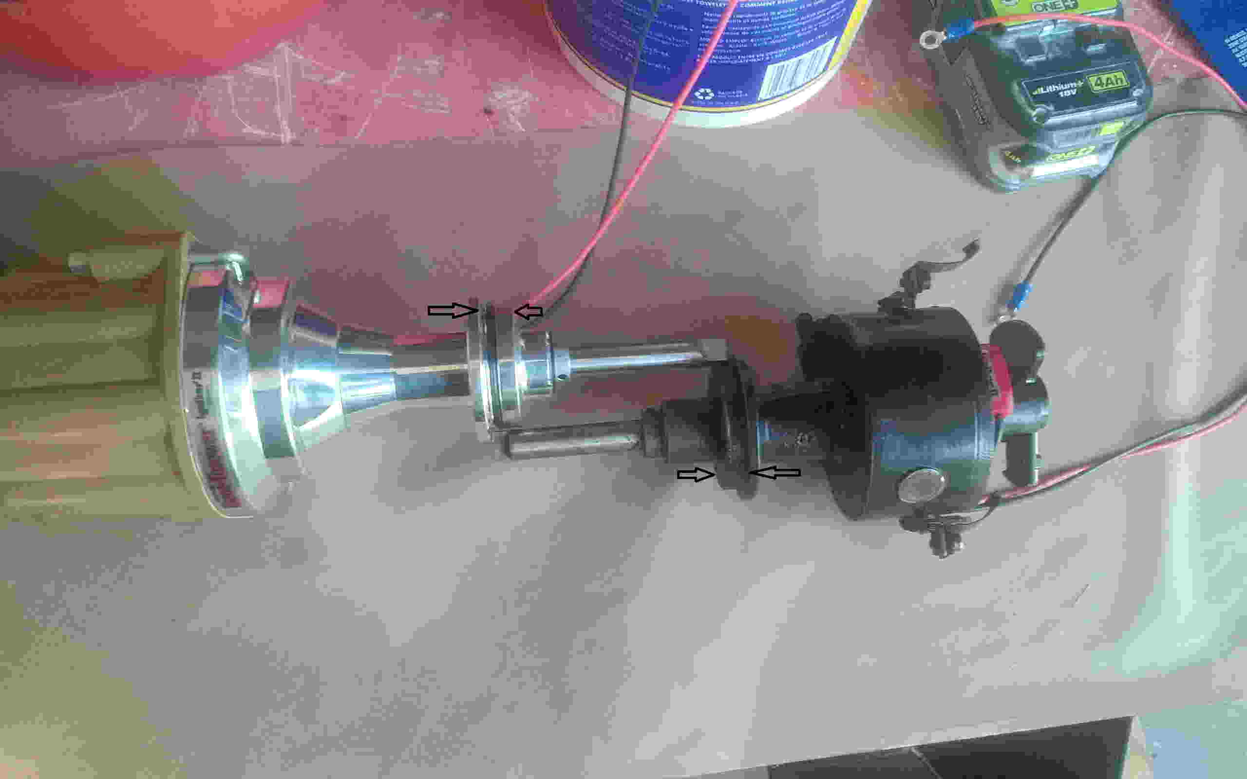

As you can see on the photos the new on is longer on the flange. The O.E.M distributor is the same both sides and the sleeve on a ccw motor is the only difference one has it and the CW does not use it. I really think they had a mistake on the last batch of housing and they will correct it. I will also let Roger know about it again when I send him the notes on corrosion this year.

Just got an update from Roger at Pertronix. He has confirmed that they have seen three versions of the thrust collar used on the reverse rotation motors and they have modified the design to accommodate all . presently until they can manufacture new they ask for the O.D. I.D. and length of the thrust collar and e-mail it to them to make sure they have the correct change. I will be ordering another unit for a friend this week and will post the outcome.

Jeff I would normally agree but I have worked with 5 distributors now ranging from late 60's to mid 70's years and they all are the same length on the flange. What I really think is they have lost the original design and made a batch from a new drawing and they think the sleeve is the problem. They have been really good people to me and I would like to help them in any way. From my finding even the car version is the same length as the marine. (have a friend with a 383 that I put my old one in to test over the winter.) If it is the sleeve Mallory and all the other brands should be seeing the same problem. I have not been doing this long 3 years now with my M but getting this correct makes for a good running boat.

Machined my thrust collar. I drop it in this weekend to see.
Needed to go 1/8 deeper and put a brake on the hole to get it to seat. Now I don't have to be held hostage by mallory or sierra for $700 distributors (I just saw a sale for $320 each)
