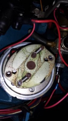

Here's what that sleeve looks like. The distributor shaft has to be a bit longer, I think, to use it.

You should have no problem dropping it in if lined up properly.
Here is a picture of my STB Dist. 3rd season. There has been some minor corrosion but easy to control. Great access to advance weights and springs. I clean with spray lube and lube pivot pins. Boat runs great and I kept the org. spring setup which came on the Dist. I tried other curves but did not notice much difference. Worked with Rodger and he is great to work with. Very helpful.
2 full seasons
2 full seasons
safe boating,
dave
