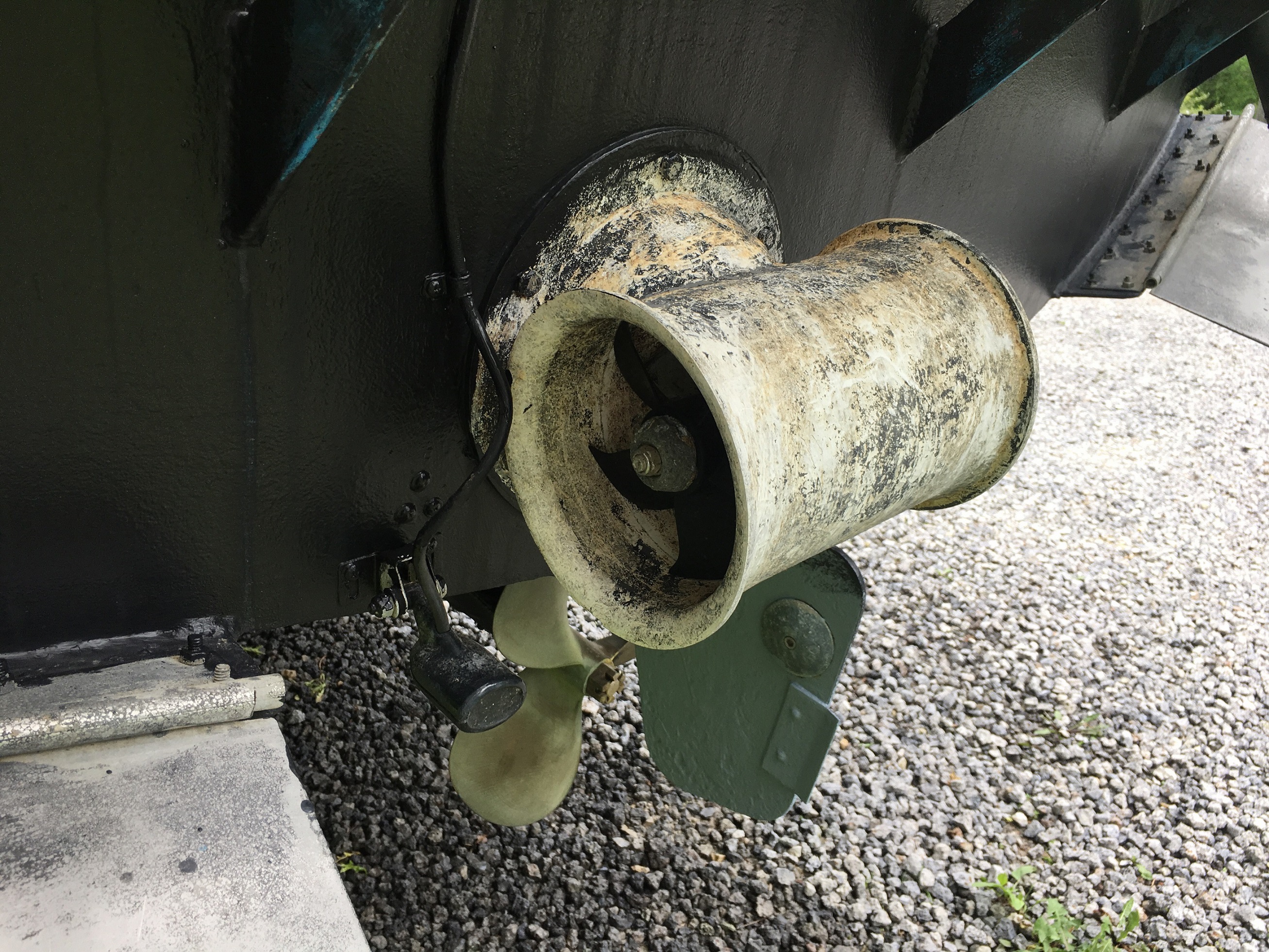

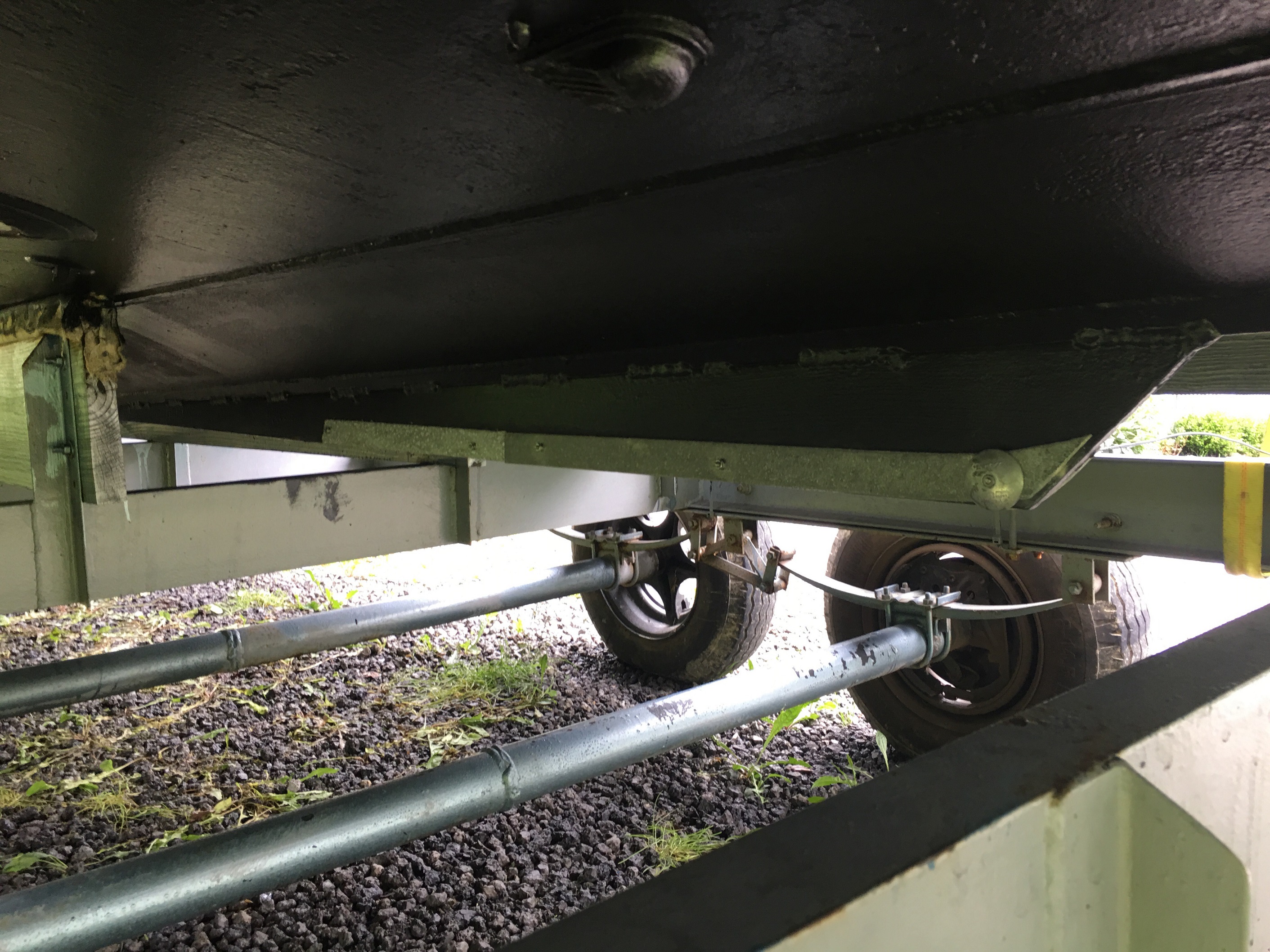

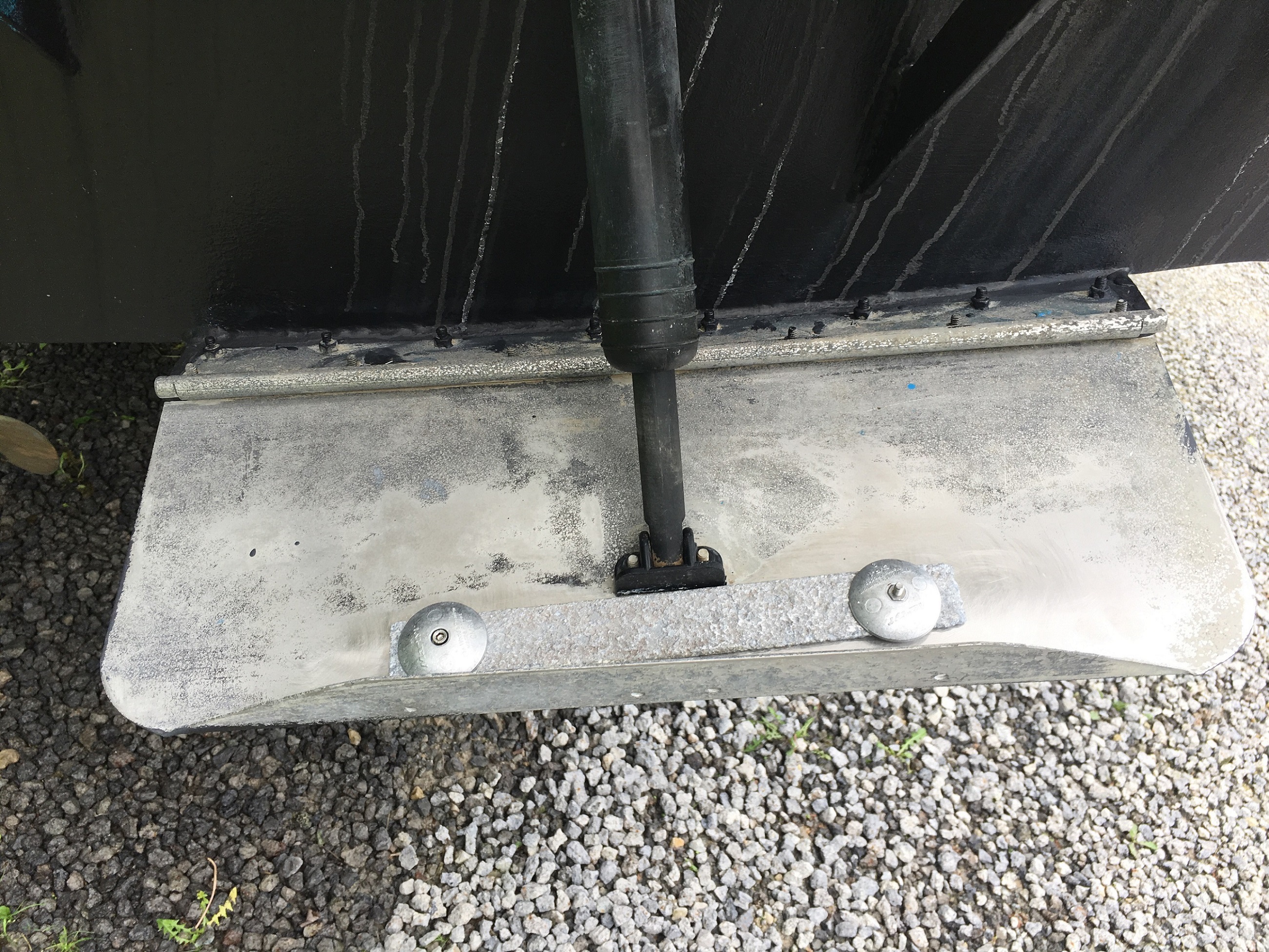

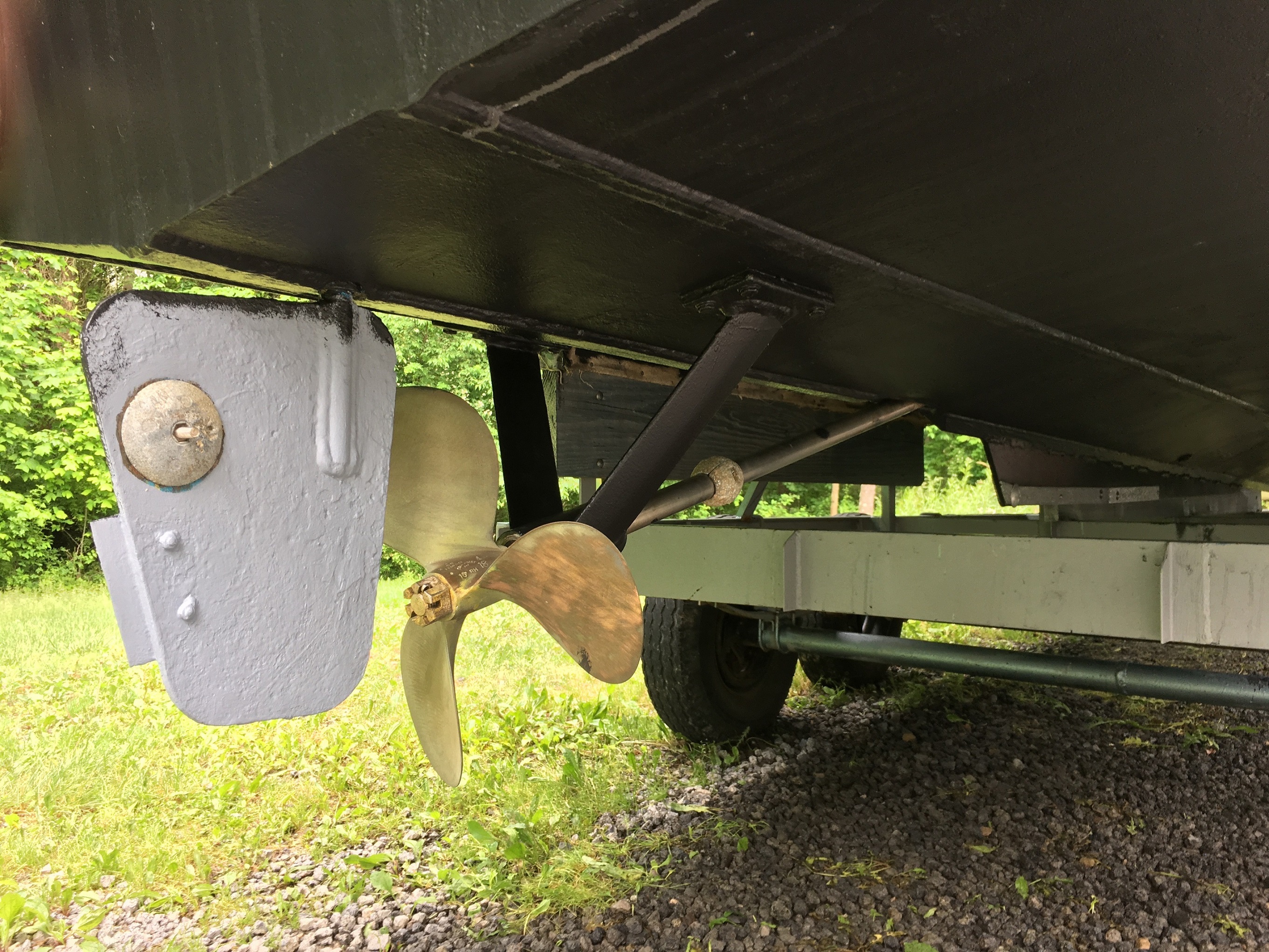

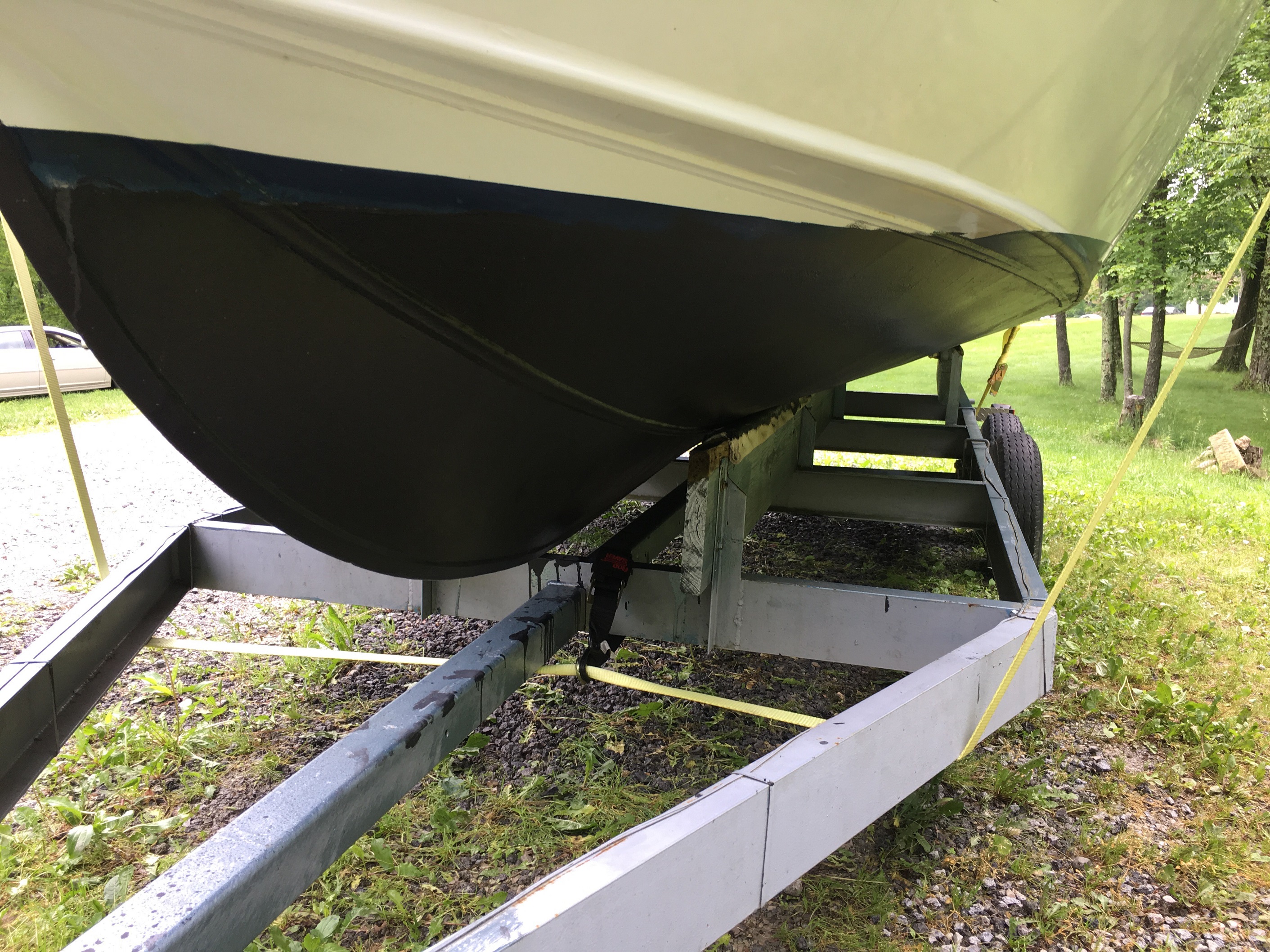

As a follow up to this post... Thank you all for the help.
I ended up sanding a few spots and painted with Interlux 2000E. I sanded and painted the rudder with 2000E also.
Then I put 3 to 4 coats of Interlux Trilux 33 black on the bottom.
I cleaned up the anodes and added a couple small anode disks to see how they do.
After pics...

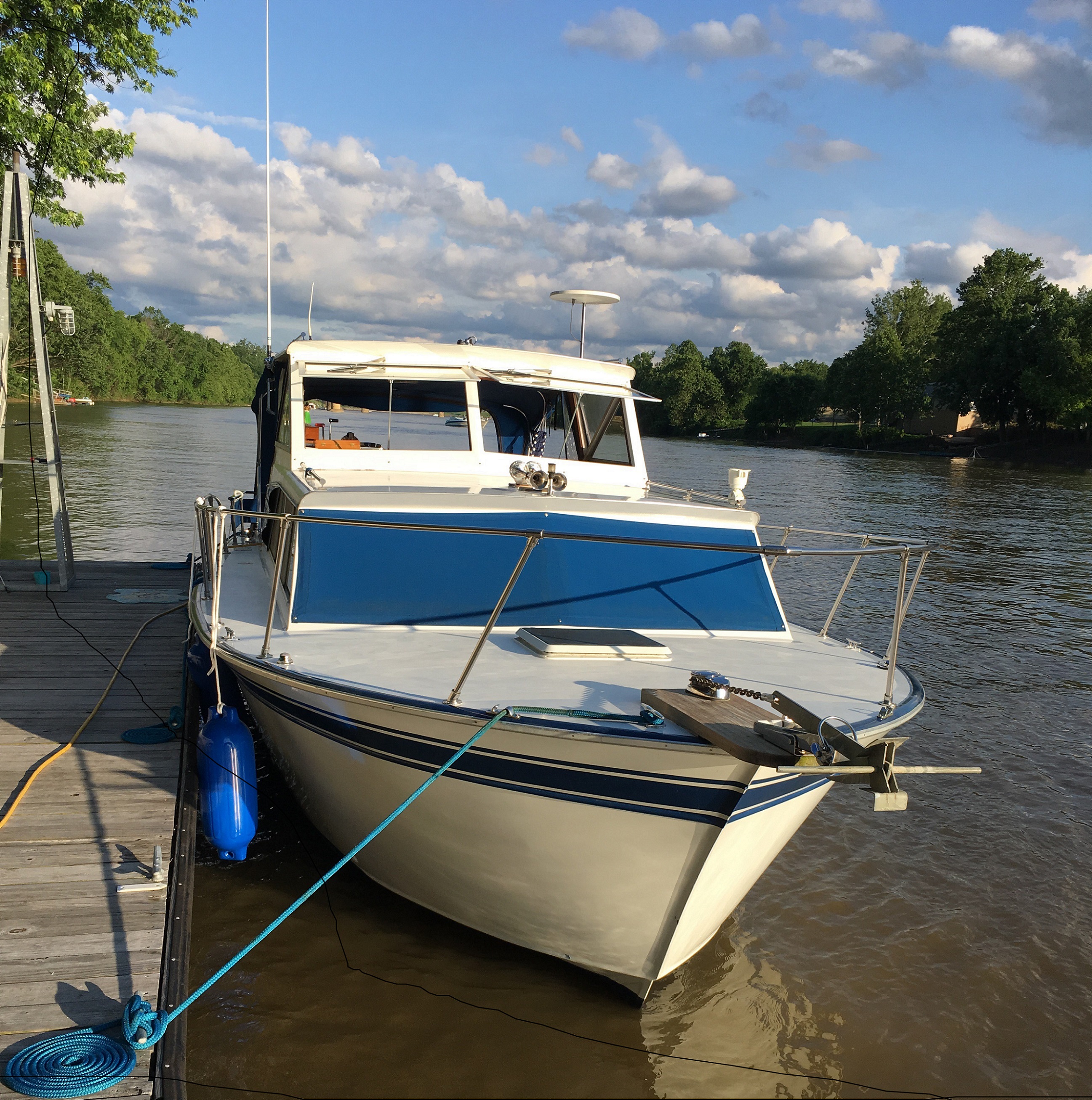

Then here she is in the water...
