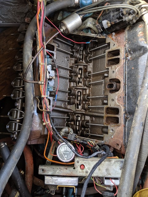

I have a new head gasket as well as all the exhaust manifold gaskets etc. I am hoping to pull the intake off this evening to pull the head. Does anyone know what all needs to come off to get the intake off? such as carb etc? Do i need to purchase a marine specific gasket for the intake or will an automotive work? It looks like there is a pretty good price difference but the marine comes with gasket for distributor it looks like?
1978 37 Double Cabin
Lake Cumberland KY
Re: Exhaust manifold removal
If yours is a raw water cooled motor, you must use marine gaskets. If fresh water cooled, automotive is fine.
The distributor has to come out and the carb as well.

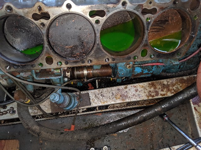

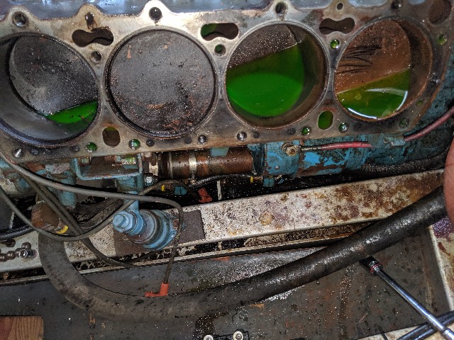

Got it, thanks Jeff I did get the intake off and head finally yesterday. I am happyish to report that the cylinders we're mostly filled with antifreeze with some surface rust on the tops of 2 of the Pistons but it has came off easily. The bores were all still nice and smooth so hitting them with a red scotch pad just to remove a little surface rust near the top. I don't really see any damage to the original metal head gasket but I can assure that it was not torqued down. All of the lower bolts we're torqued but the 4 bolts across the top near the intake we're just tight no where near the pressure had to be used to get those out. As soon as I pulled one of them the head released lots of antifreeze. When I pulled the last one the head fell off the block on it's own. The front rocker arm on the head is totally rusted and the whole front few inches of the inside of the head are rusted extremely bad. It does seem to wipe off easily but it sure looks bad now. I am wondering if there was some sort of exhaust blockage that caused an overheat issue that in turn blew the head gasket. Or vica versa?

Believe me would love to have a new long block although getting current one out would be more work then a head gasket for sure. Just hope the head gasket is the issue. Old one looked great which was a big disappointment. I was hoping to be able to look at it and say that is where the problem is. All I know for certain is that there was some heavy rust under the valve cover on the front end and the cylinders we're all full of antifreeze. This is a closed cooled block and wet exhaust. Really hoping I don't have a cracked block or head.

Sounds like the head was not torqued, so the gasket did not seal and everything leaked. The old gasket may still be good, after all it has never been used. The correct way to torque a head is to do the final tightening from the middle working out to the ends in a staggered pattern. Go to the library and get a MOTORS manual ( the librarian can show you where they are ) Just look up a Dodge pick up of about that year. It will tell you how. It will also give you a lot of other information and will be interesting to read. I would just clean it all up, oil it up with clean oil as you assemble it and see how it runs. ( the difficult part to explain is how to time the ignition and how you can be 180 degrees out )
