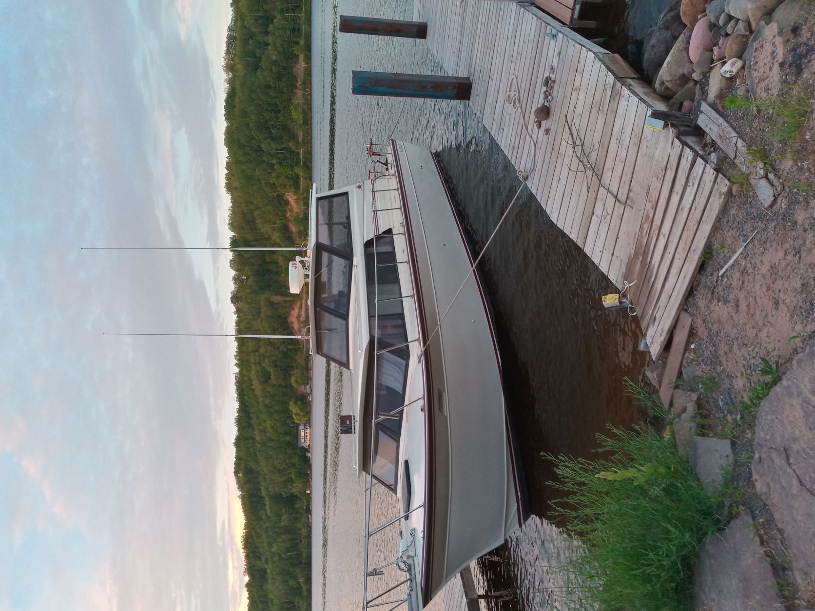

Found another pic of the first launch.
Rodney
- Posts: 270
Re: A little crazy?
As we all know, fuel prices had been ridiculous this past year. One of the main reasons I want to add more fuel to the boat is that when we go on our Isle Royale trip, we travel around 200 miles round trip. Only carrying 150 gallons makes me have to refuel at the National Park, this past summer it was $8.68 a gallon over there, OUCH. That added up real quick and the wallet still hasn't fully recovered. If I can add 100 more gallons, I should be able to make the round trip with extra capacity in case of foul weather.
