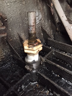

[img]
[/img]Sorry guys - sure this is covered somewhere on the site, but what are you replacing these with?
