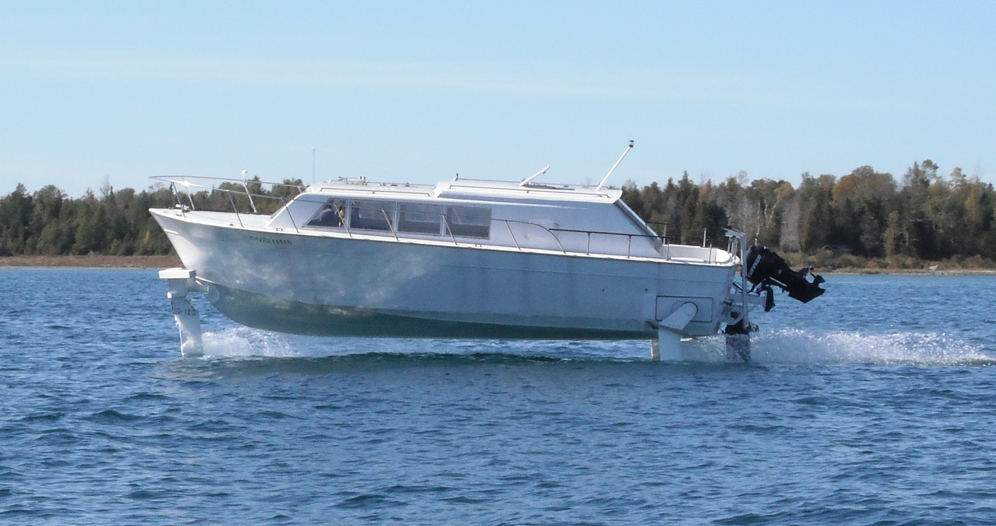

Here is a picture of the boat. I added ~1200lbs of sand bags, and 5 passengers and the MPG dropped to 2.0 at 30 MPH. 3450 RPM. I have an alarm going off near 3500 rpm. I'm not sure what it is, but it turns on quickly as the RPM nears 3500 RPM, and off as I back off. I verified the Tach is correct with a hand held tester, the oil temp is fine. The motor has smartcraft, so I will have to get the bluetooth sender next year, and figure this out.

Damn cool LCR! How much of a spacer do you have on the Bravo 3 to get it to grab water?

Is it possibly starving for water at 3500? Usually the alarm is for low oil pressure, low gear lube in monitor bottle or engine overheat.

I do suspect water starvation, but it is really odd how quickly the alarm comes on as the RPM goes up, and then off as the RPM drops. It happens reliably in a second or two. The extension is about 5 ft.

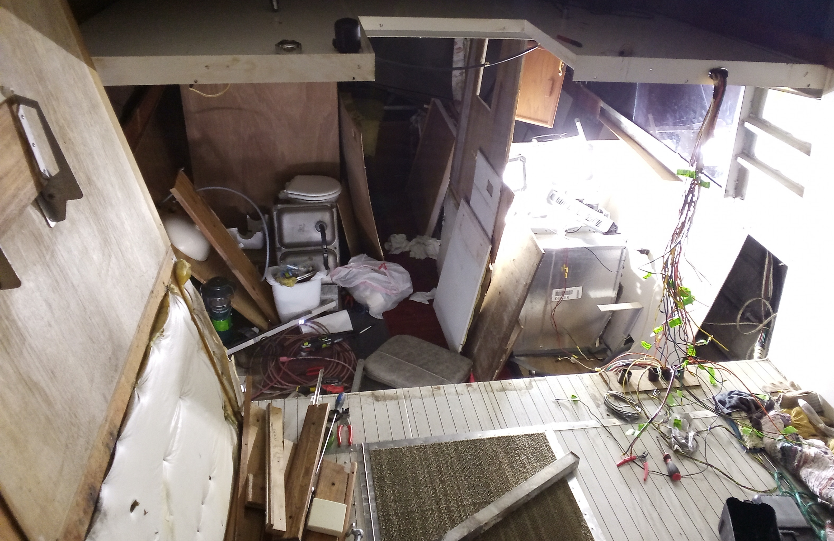

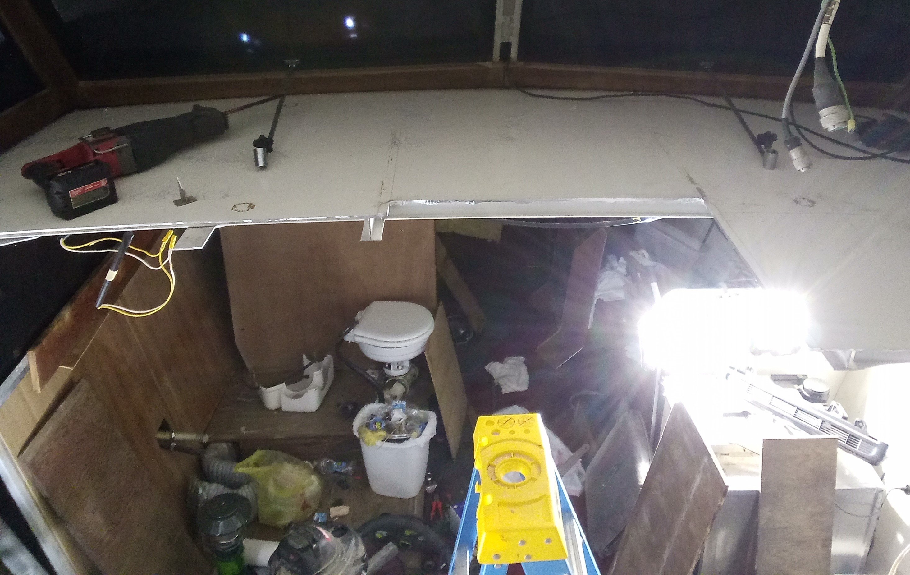

Here is the start of the interior remodel I did last year to move the helm forward 18" to install an additional 130 gallons of fuel.
