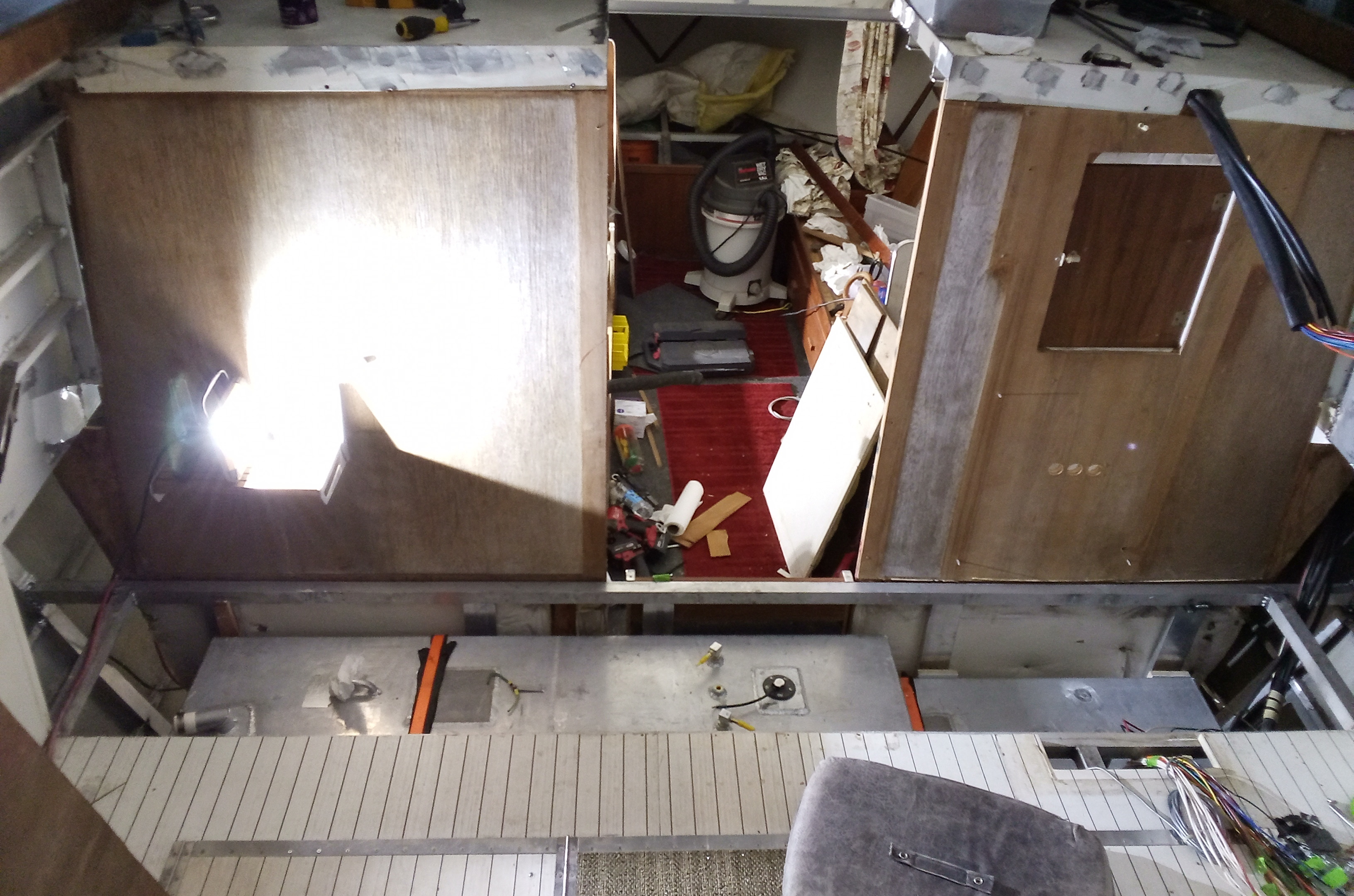

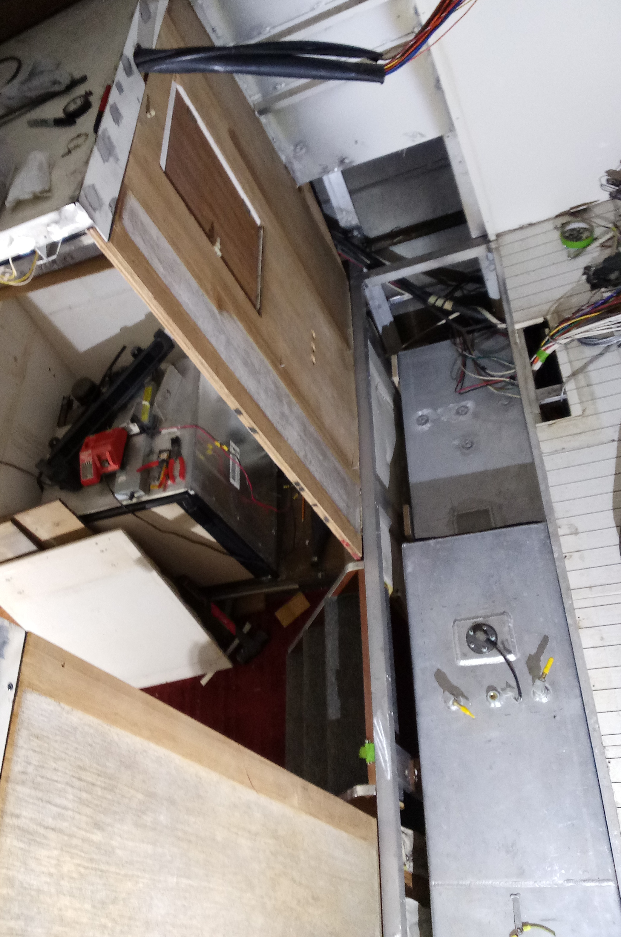

I had moved my helm forward 18 inches, which shrunk the cabin the same amount. I was able to get an additional 130 gallons of fuel onboard. Now I hold 280 gallons total. I still have some fit and finish to do, but over all it was worth it in my mind. We travel to a National Park that is 70 miles dock to dock, 60 miles of open Lake Superior. The gas out there was $8.62 a gallon last summer. So now I can make a round trip with plenty of reserves and not have to buy fuel over there.

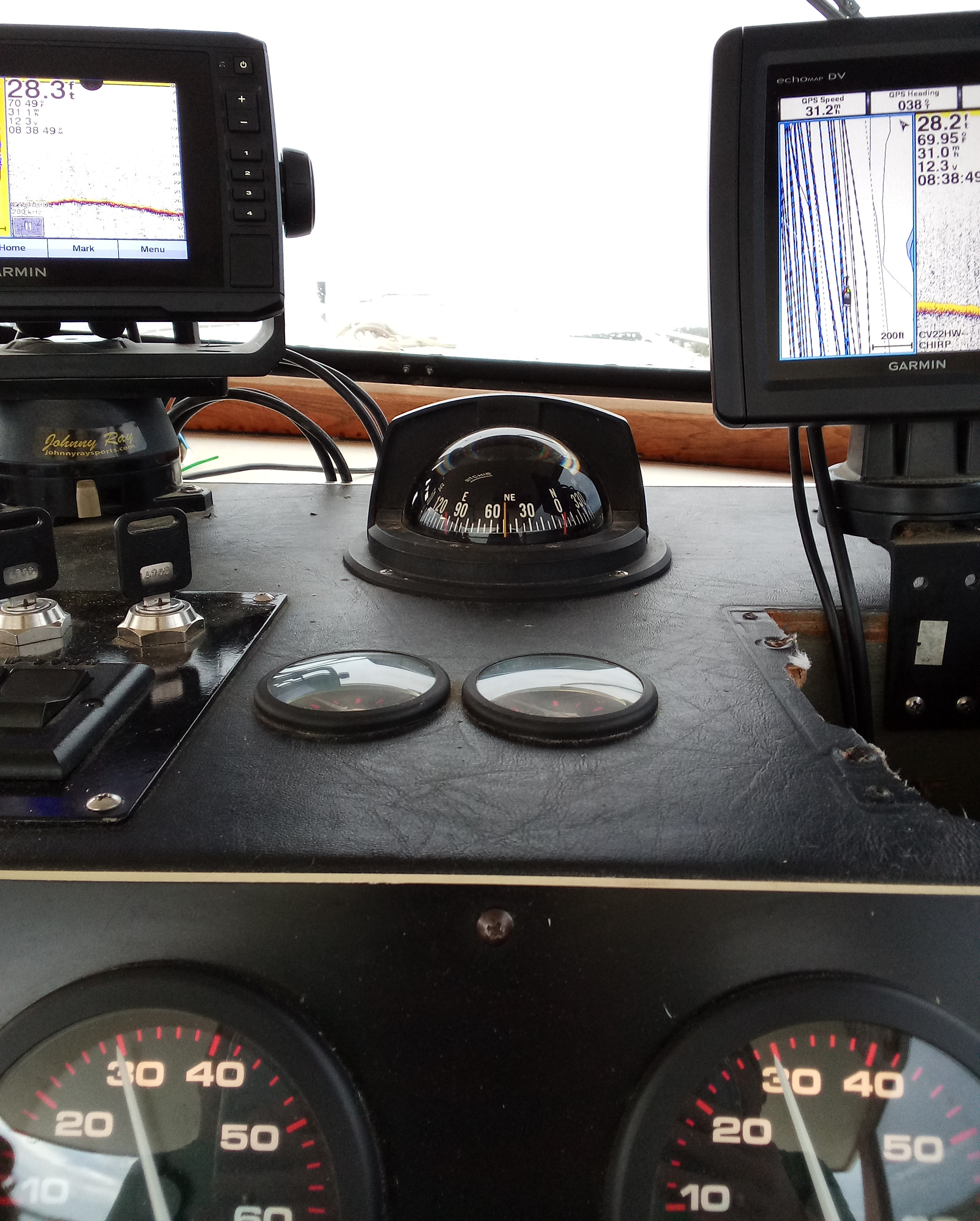

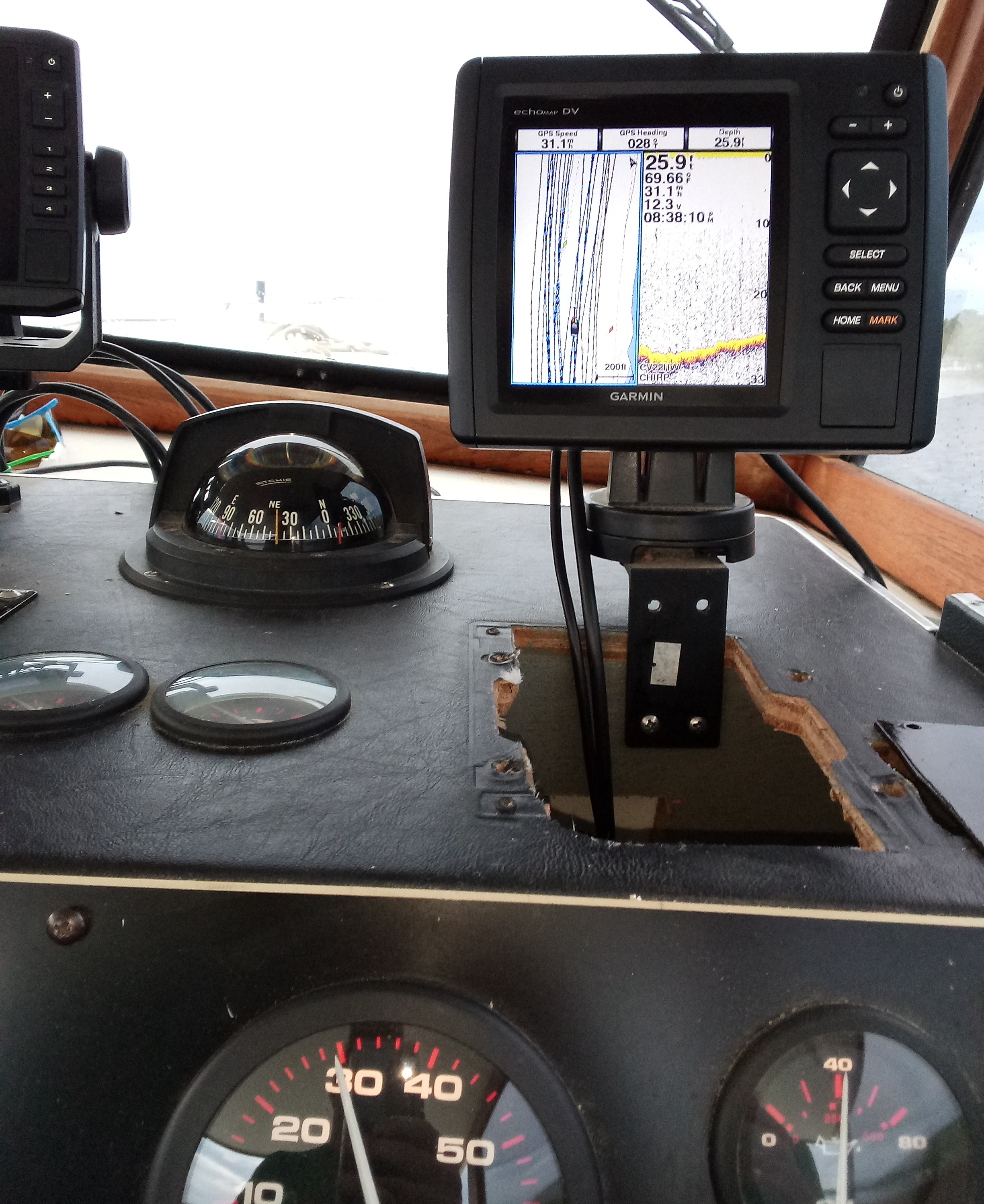

The last few pics were of my Garmin chartplotters showing the speed of 31mph at 3,000 rpm. Getting a 1.3 mpg with a pair of 454 Chevy's.

Don't mind the big hole in top of the dash, it was a temp spot to mount the chartplotter while doing the water test. It has been covered.
