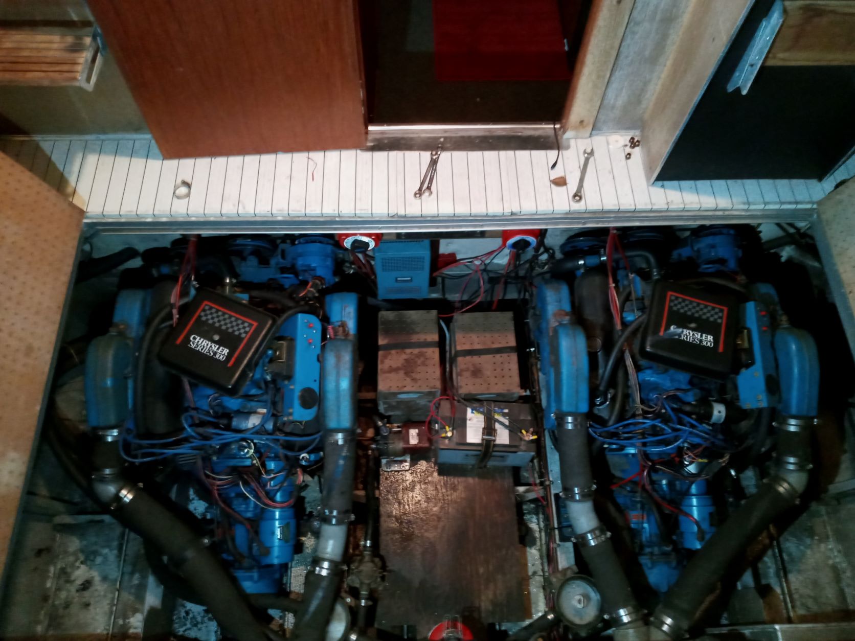

Posted: Tue Nov 22, 2022 6:09 pm
by TinLizzy
Last time the 360's will be in this boat?
