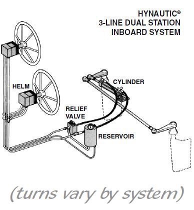

Question. Anyone have a picture of how they mounted the hydraulic cylinder? IE": What did you hook to? How did you figure out the proper throw? I'm new to hydraulic steering and have never messed with this stuff before. My upper station helm (soon to be) has three hydraulic lines. I'm guessing that this brand "hynautic" has no side tank and that it simply holds the fluid in the wheel pump.
Looking for help or pictures.

I have to take my flybridge off to store my boat in a building with a 14ft door. The hydraulic steering is an easy removal. You just take out 4 bolts behind the wheel and drop the pump on the deck. The mechanical engine controls are harder. I do not see how a combination of mechanical and hydraulic steering would even work. The mechanical controls are not isolated at all. The device to actually move the rudders is a cable or cylinder and would have to be one or the other. I have an original Hynautic system that works perfectly with two helms (pumps). There is a pressurized reservior mounted on the inside of the stern. If you got a used Hynautic system it looks like you may not have it all.

These are the components you will need

One thing to consider with not disconnecting lower helm... If anything falls against wheel it may lock up your steering. Not sure if manual steering will work against hydraulic pressure in the cylinder and system. Check ebay for the other components you will need. I suggest doing both helms, you won't be sorry. Hydraulic steering is great. And easier to add autopilot to in the future.

Hi if you use seastar hydraulic helms you do not need a reservoir or a relief valve. The helms acts as the reservoir and they have internal safety relief valves built in. I think it would be very difficult to put hydraulic steering on only one station.
