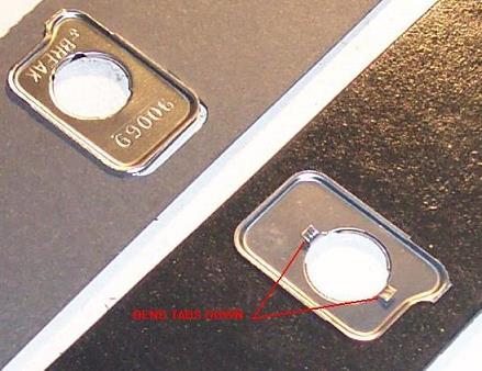

I'll bet you a steak dinner it's leaking from the intake manifold, in the center (where the choke heater circuit is). The intake gaskets MUST use these little metal plates to seal that area off or it WILL leak.
Here's what the deal looks like,
