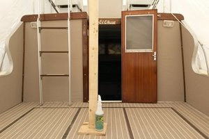

When I bought this last fall, did not have any wall panels. I did use 1/4 plywood and covered with vinyl. Just need it to last as long as I do.
