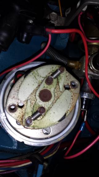

Will inspect and photograph and post results if I can figure out how to post a picture on this site.
Here is a photo taken at spring start up.
You can see it is in pretty good shape. (boat in water all winter)
You can see the corrosion at the pivot points on the weights. The rest is pretty good shape.
I did not lube them they are right out of the box and installed in June '13
I really like the access to the weights and the springs.

Mine were worse than that. I even sprayed them with boeshield corrosion inhibitor before the start of last season,Didn't do much at all.
I am guessing I need to sand and oil on a regulator basis to keep rust off.
