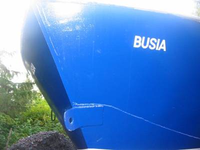

The skin is 5086, extrusions for the stem and keel are something else. 5086 is hard to find, mostly 6061 is used, and the filler wire for a MIG gun is different like Jeff says. Here might be a pic of what I did. Strong enough to pick the boat up using the eye.
Bow eye 12k.jpg (12.74 KiB) Viewed 9808 times
__Ed

Nice job on that trailer eye.
