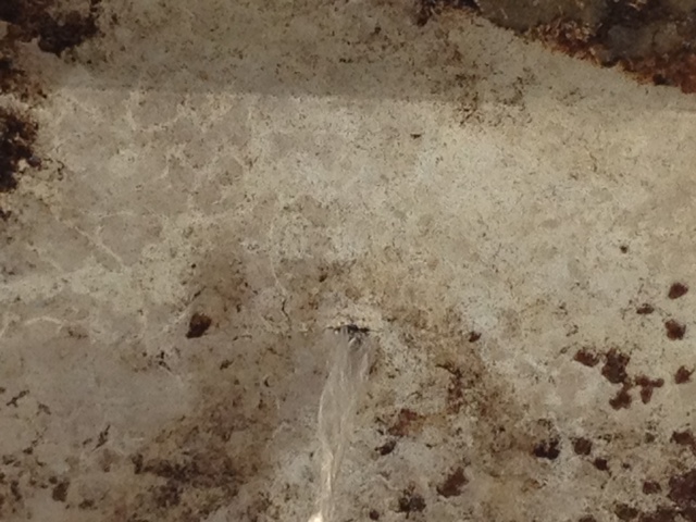

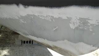

I'm looking at aluminum houseboats - mostly Marinette & Kingscraft.
I found one that has been remodeled but hull was refurbished in an odd fashion.
The hull was completely sandblasted down to raw aluminum. The owner repaired what they call minor pitting along with a small hole into the water tank in the keel. They covered this with resin / fiberglass. They also left the hull unpainted - I suppose like some Somerset's that I've seen.
What are your thoughts regarding this method of repair?
I've often wandered about unpainted hulls on BigM or Kingscrafts. What do you think?
Here are some pictures.

Your photos are not a houseboat.
Your first photos I would NOT call "minor pitting"!
Proceed with caution: A professional surveyor with aluminum experience would be wise.

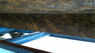

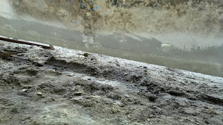

I also have these pictures of the keel area before repair. This looks bad to me.
Re: Aluminum houseboat hull
There's pitting, and then there's so much local corrosion that structural failure is possible. Pitting damage can be repaired with epoxy putty; the other requires welding. Fiberglassing over aluminum--if not done correctly--will fall off!

What caused the corrosion? Could be some serious electrical and isolation issues
