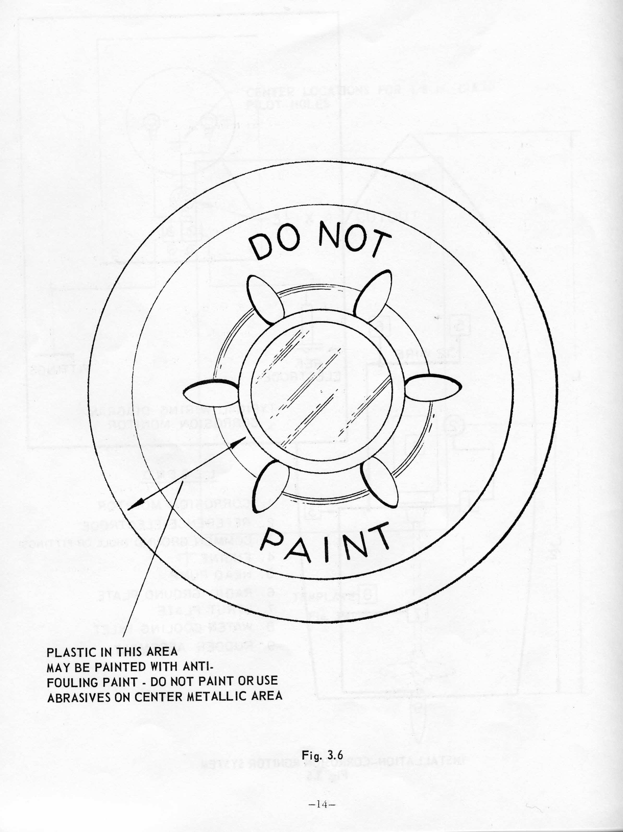

Carl..I'll attempt this but I can't conjure up all the tech detail. Yes, it''s a thru hull, usually mounted (at least it was in the '88 FBS model I had and others where the helm was port side) aft of mid=-ships on the port side. It measure the electrical potential of the hull using a silver/silver chloride metal detection plate on the water side. I believe it's grounded to the hull inside and is not connected to the ship's electrical system. You can't switch it on/off. Pressing the button on the readout panel closes a circuit and causes the needle to register the potential. For our hulls, the proper range is marked on the instrument.
Silver/silver chloride plate is quite thin and delicate so never scrub it down with anything tougher than a sponge (lightly please) and don't paint it because paint interferes with its contact with the water, rendering it useless.

One lead from the meter is connected to the hull, usually a stringer near the engines. The other lead is connected to a special insulated thru hull on the port side, about midship, just up from the keel. Kind of looks like a 8" or so dinner plate with a 2" metal disc in the middle. The plastic insulator "the plate" can be painted. The metal disc cannot. Don't scrape it, blast it or any other abrasive as it has a silver coating.

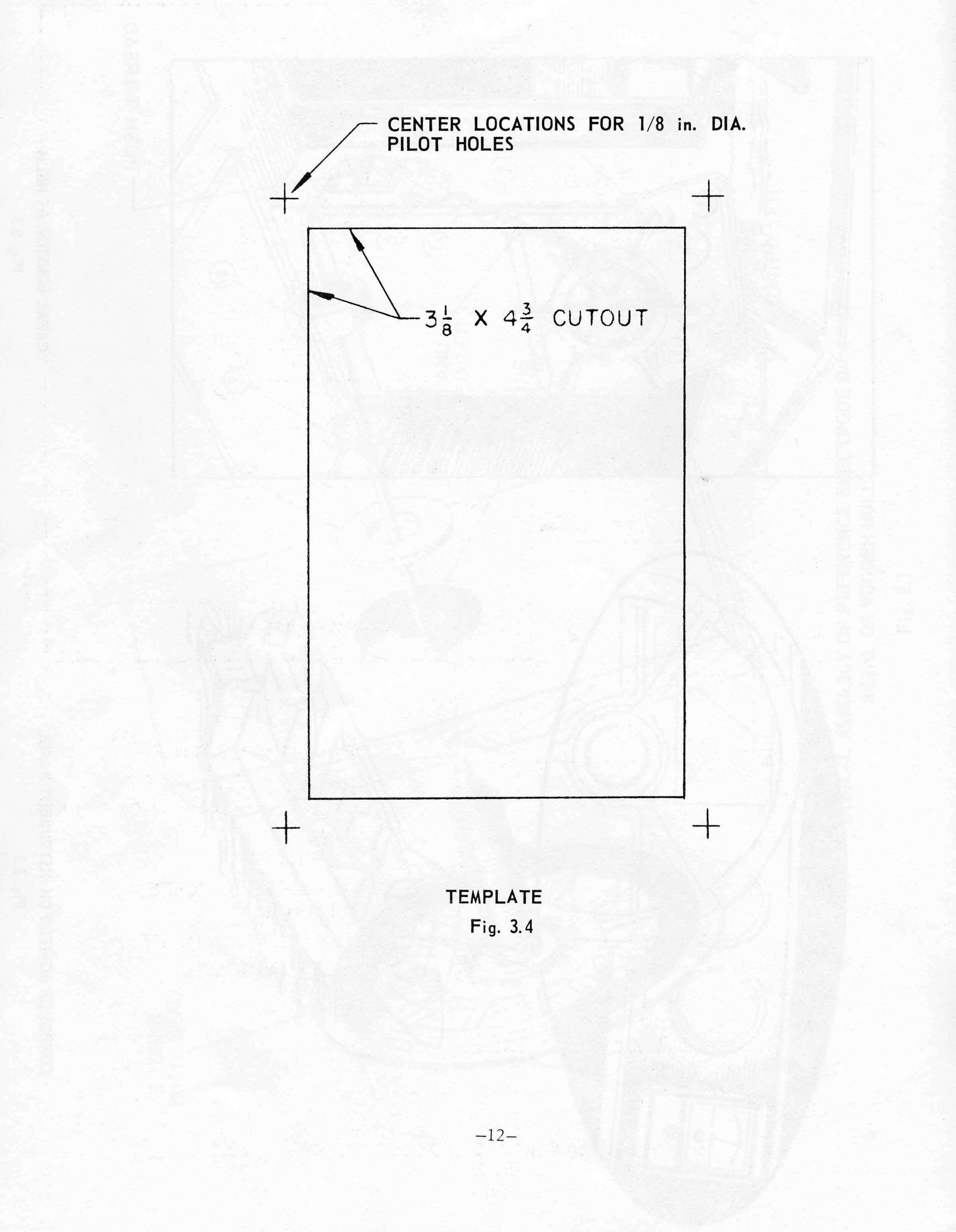

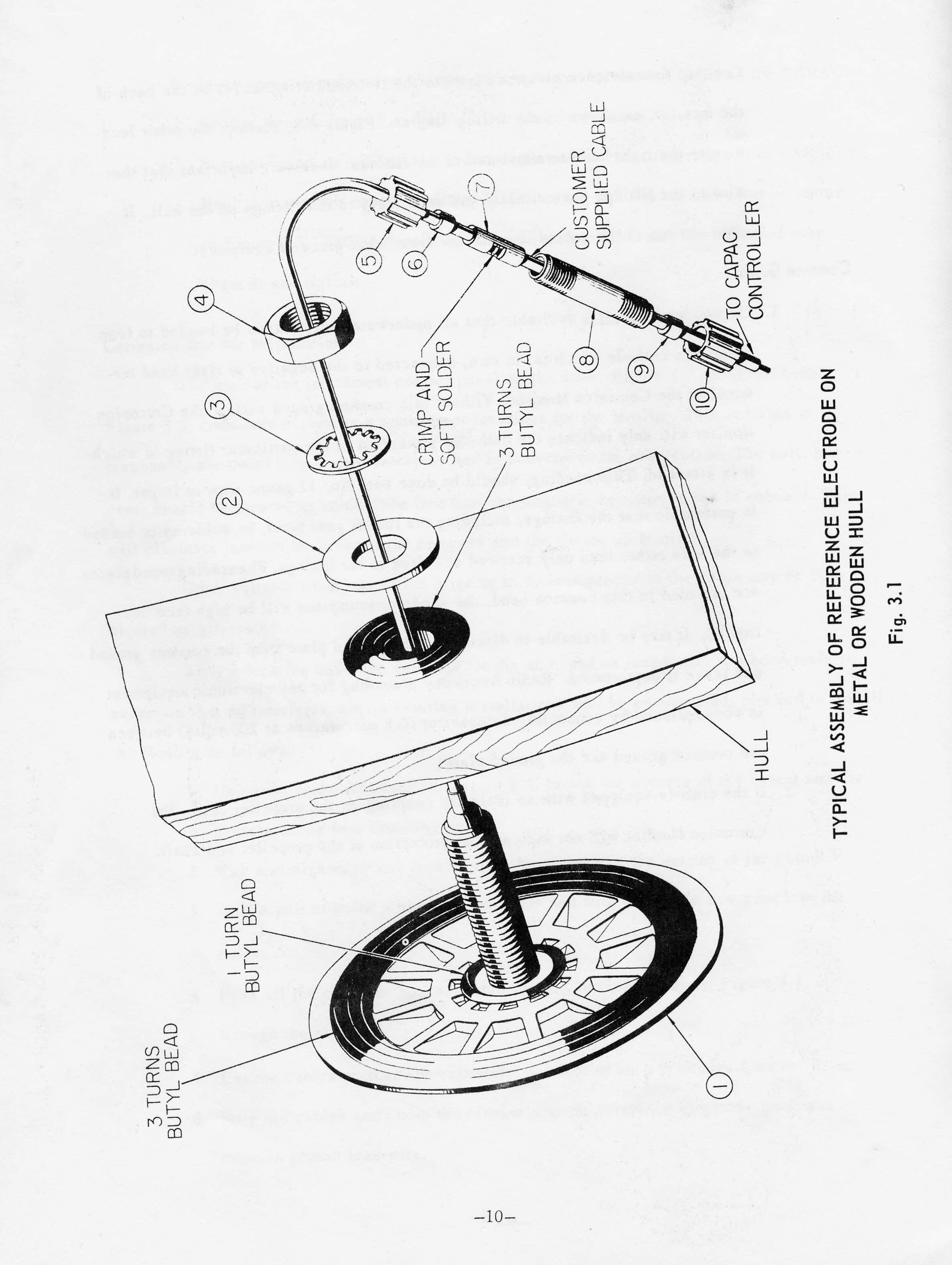

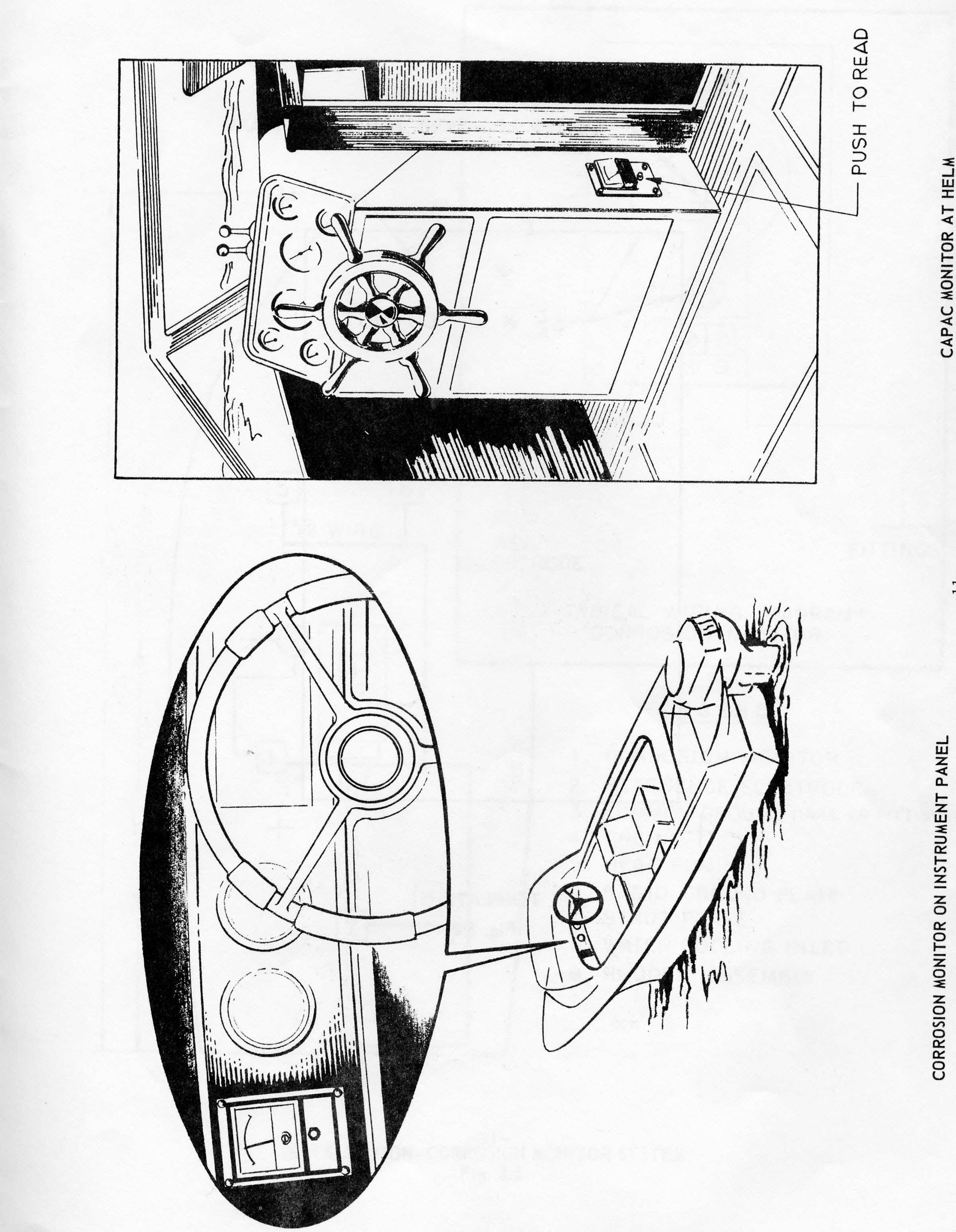

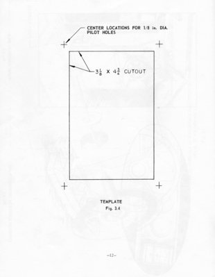

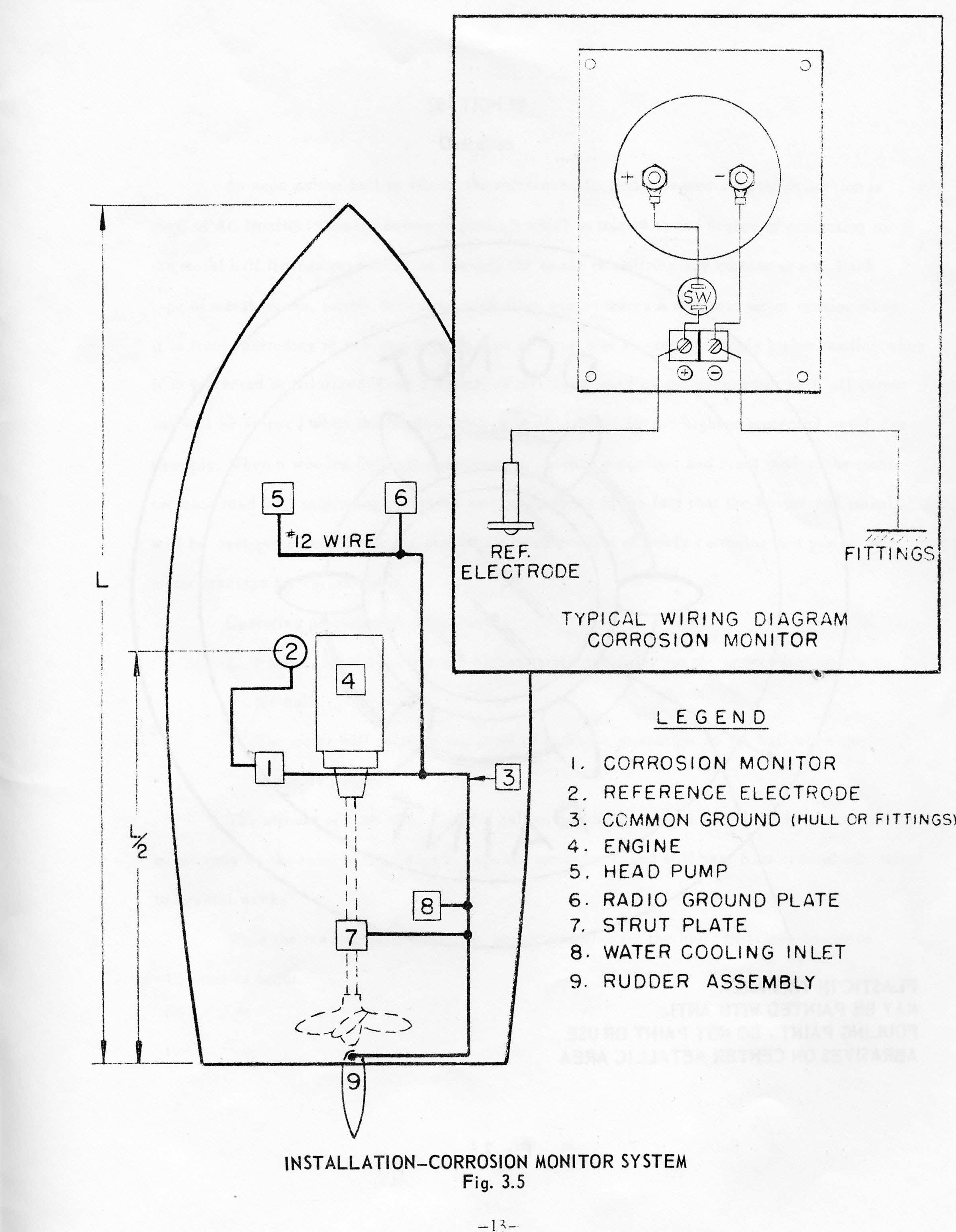

check the attachments - lots of pages but here is the Capac Manual. The site wouldn't let me upload PDF's so here is a jpg version. Sorry if the print is light.
