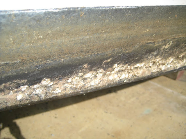

When I pulled my boat for the first time the anodes looked great after 3 years....I was baffled myself...after a little investigating of my own (not the marine mech) I figured out that some BOZO put sheet metal pieces on as anodes Eh? ...I guess the previous owner got ripped off ! Hull had popcorn corrosion that had to be repaired.
Pics here
Maybe you have or had sheet metal anodes as well Think
