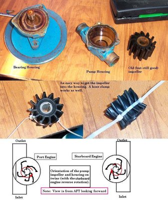

Yes, but its body is attached to the frame differently, and the impeller is installed with the vanes going the other way.

I have printed off a copy of Jeff's pic above years ago and to this day it sits on the shelf where I put the disassembled impeller parts for each engine. The following spring (like in 2 weeks!) it comes down off the shelf as my "go to" assembly instructions!
Thanks Jeff!!!

Now..I remember (yes, thanks, Jeff). One year the mechanic installed the impeller backwards on the Stbd engine and when we started the boat, it blew water out instead of sucking it in. Giant bubbles coming up from below. A very quick shutdown reaction amidst lots of hollering saved the day.
