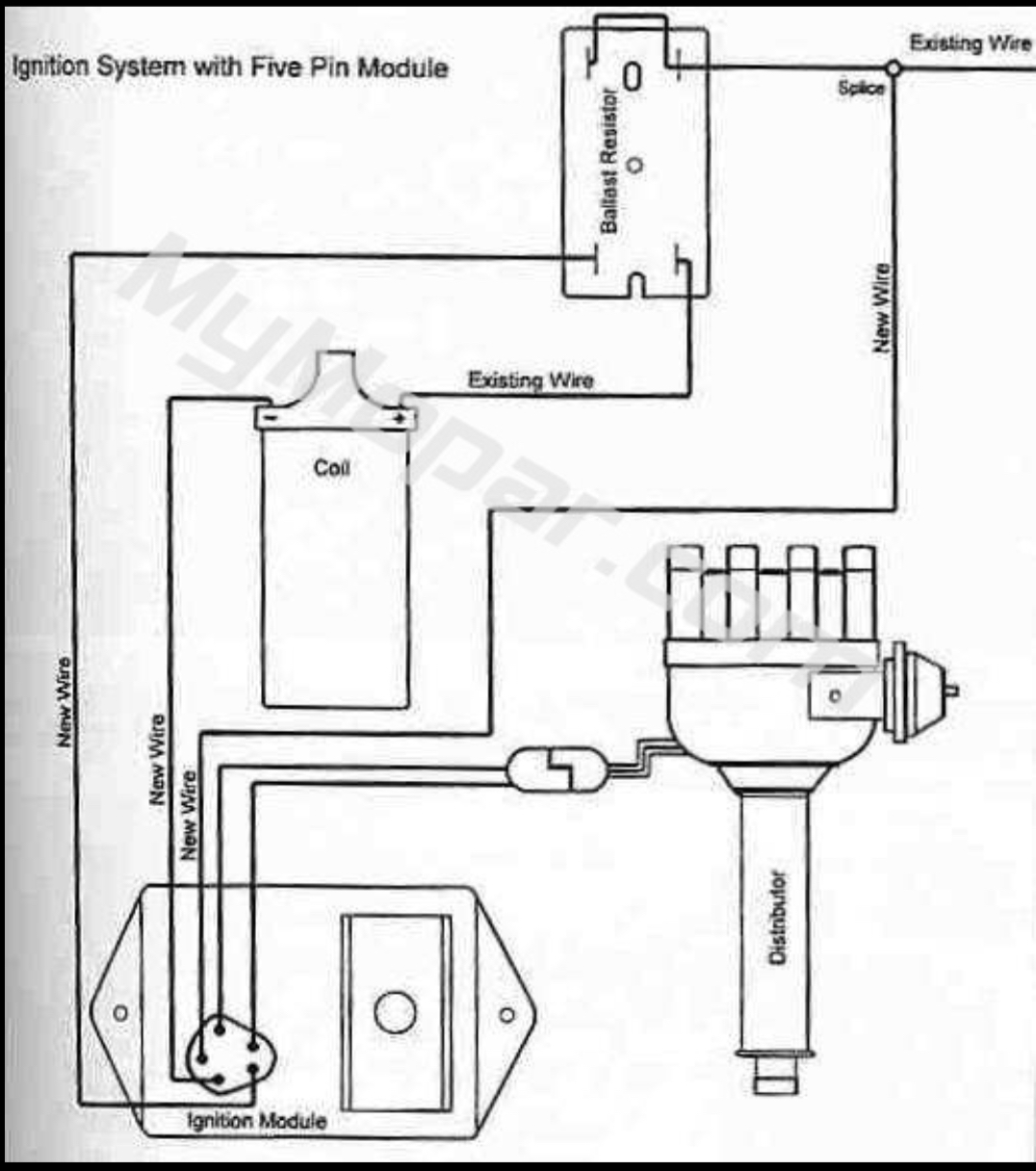

I am going to upgrade to the below pertronix distributor. I want to get away from the stock ignition system.
PerTronix Flame-Thrower Plug and Play Marine Distributors with Ignitor II® Module D241800.
How would I wire this?
Would I wire this from the starter solenoid to the coil, coil to the pertronix bypassing the the Chrysler ignition system (5 pin ecu box, wiring harness, etc...) I read that if I buy the pertronix coil I don’t need a resistor.
Found the below wiring diagram while researching.
