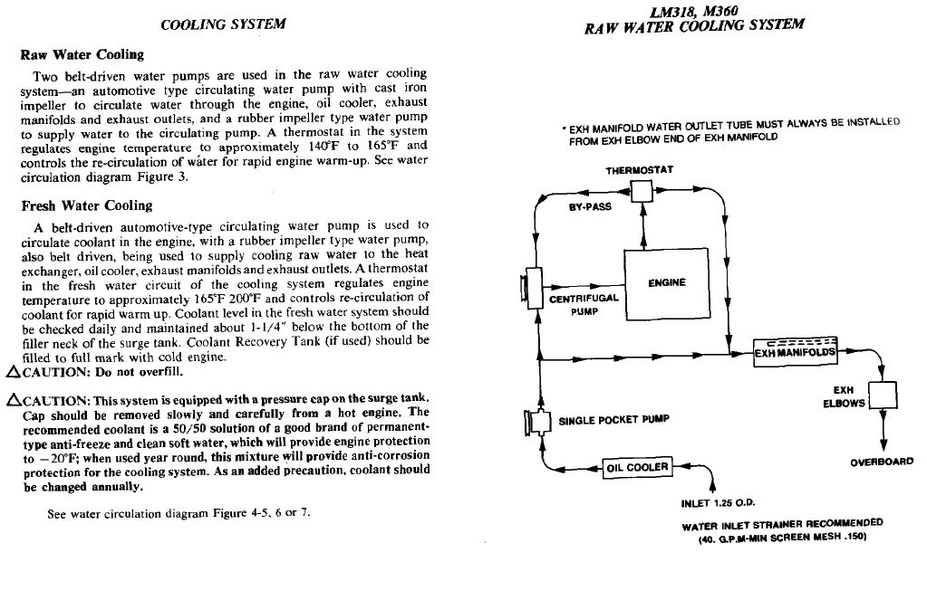

The old site had a flow diagram. Could someone please post it again.

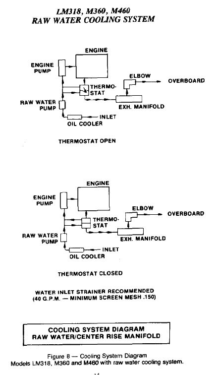

I thought the flow goes into top of engine through the thermostat. Much to my surprise while winterizing I found that the block fills with water and flows up through the thermostat.
Anyone with knowledge please enlighten us.

I found these diagrams in the Chrysler Engine manual and I think if you click on them, you'll be able to read them (-if not get an electron microscope)
ChryslerRawWaterFlow

Thanks jralbert. That is exactly what we need. :lol:

Thanks jralbert, couldn't find mine this summer to give to a friend. Had to draw one up w/o info , but did give pics which helped .
