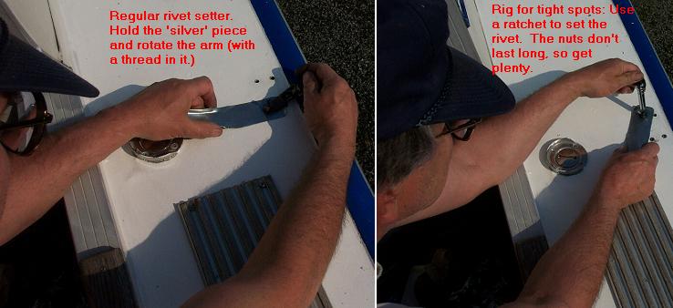

Re: what to do when railing screws are stripped out
I've tried a rivet gun with a threaded "rivet" end (that pulls them up tight) but it kept snapping off on me. In frustration, I returned to my rig with the grade 8 bolts and nuts.
The trick (shown in the photos) is use a metal 'arm' with a hole drilled in one end to pull the rivets up. Thread the Allen bolt through this 'arm', through a grade 8 nut, and into the rivet. While holding the arm, you tighten up the nut.
Use lots of anti-sieze on the threads, which only last a half dozen times before needing replacement.
