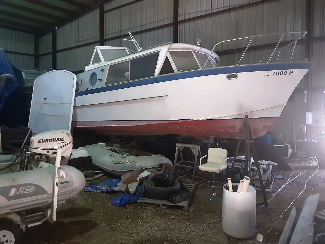

New to the Marinette cruisers line but not new to boating in general. We boat the upper Miss pool 13 area and have for some 40+ years. Looking for some insight on the below attachments.
Picked this up from our marina, been sitting in storage for 20ish years. Prior to that best I can tell from previous owners paperwork might have been in use somewhere around mid 90's. I know at one time it had a hard top over the deck area. It has a single gray marine fireball V8 188( which is missing some intake parts). Unsure if it even turns over yet. Intentions are to fully restore, and most probably repower with a modern gm motor.

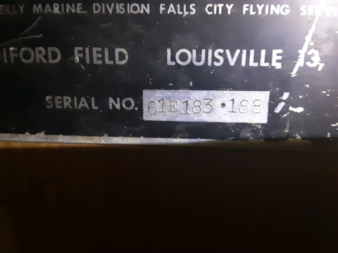

Guessing its a 1961 model based on the tag??
Measured out at 96" wide at transom, 30'6" length transom to nose.

Just going off the looks of the boat, i would think that you are correct in it being a 1961. As for the length, I believe they used the overall length, not the waterline. Good luck on the resto! It is nice to see these boats saved from the scrap pile.

This is a 61 model convertible. Or has had the top removed. What is the width of this boat at the front of the cabin? You may come out better dropping a later model Mercruiser GM block V8 in to replace that 188 Gray Marine.

Would really like to convert to twins with either crusader or mercruiser. GM regardless. Not sure there's even enough room for twins, I suppose you could offset them. Boats only 96" wide at transom.
Beam dimension at forward cabin is 104" ish.
