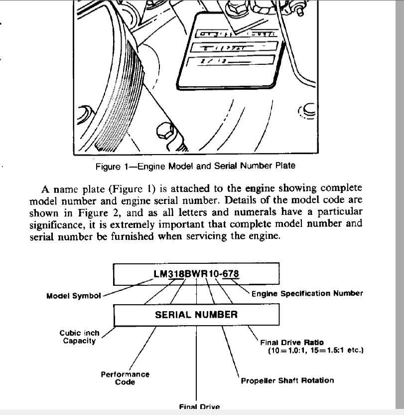

I hope this helps - if you can find the tag, the rotation is part of the serial number.

If, like mine, the original engines with their ID tags are long gone. Even engines with metal data plates get thrown out by engine builder. I can't remember which ones are LT and RT rotation. The two starters listed in the factory Chrysler parts manuals are 2875927 and 9575928 plus 14 different part numbers to rebuild one, not sure if any are still available. The only two parts that make them LT or RT are the armature and the Bendix, all the other parts are the same. If you google the two starters, it looks like there are replacements available, some being the newer hi-torq mini starters.

just recalled that another place to look for rotation is at the rear of the transm. There may be an arrow stamped there.

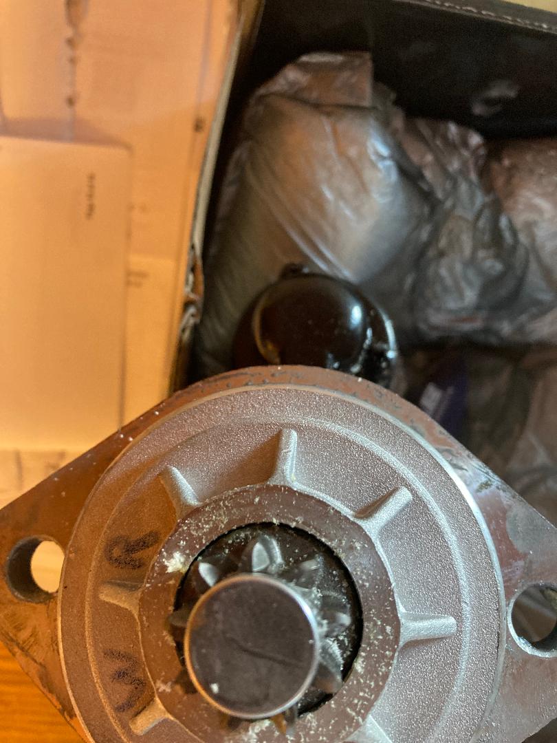

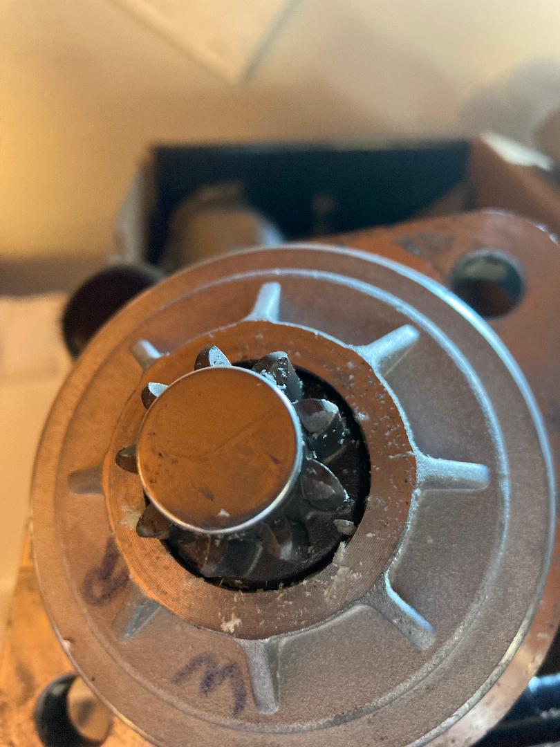

You can check the direction of rotation of the starter motor by connecting it to a battery, but you can just look at the gear on the Bendix that engages the ring gear and match your old and a new starter. There is a slight bevel to the teeth of the gear to help it engage. Opposite rotation starters have the bevel on opposite sides of the teeth. I believe a standard rotation starter has the bevel on the right side of the tooth as you look at it.
