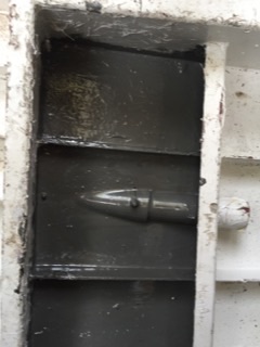

I wanted to share the final product. This is the starboard shaft log. I had extensive damage on the port side and welded thin plate over it. Bill said use a $h1tload of JB weld and I decided to do just that as well. For good measure I pored about a 1/2 inch on the starboard side as PO had obviously tinkered around there. Now both look like this.
(It's Belzona by the way) radical industrial stuff sort of like JB Weld

That Belzona seems like some bada$$ stuff. Did some research on it. Which product did you use?
Thanks!

I had all sorts of ideas as I have witnessed repairs to hydrocarbon processing units and even seen machined parts. The Belzona folks talked me into pouring in 5831 to a thickness of about an inch. I am in awe of the strength. I have never seen anything like it. Built in galvanic corrosion protection a plus. A tech offshore claimed he would dip a brush in it and brush pipe stantions submerged in salt water and It would still stick and cure. Warning though it is more expensive that you can imagine. 500-750 gallon
