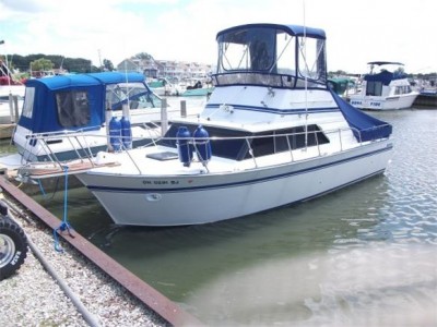

For the last 6 months I have been lobbying my wife to get a bigger boat.. We currently have a 1994 Grady White 18 ft spirit center console. She has finally agreed and we have looked at all kinds of boats from Grady, to Bayliners, to Maxums, and now a 1986 Marinette 28 sport fish fly bridge. I never though i would want to own a Marinette, but when the broker said he found me one that had been pretty much restored, I had to at least give it a look. during the initial inspection of the boat I then fell in love with the fact there is not Stringers or transom wood that can rot!!! This was my main concern with the other glass boats we had been looking into. The boat has been painted in imron, the cockpit has all new deck, the electrical looks brand new and the boat over all has been gone over with what seems a fine pick and there is not a scratch on it.. the owner is very maticulas and does not want to sell the boat but due to health reasons he can no longer get on the fly bridge... I also was impressed with the availability of the Chrysler engines and how SIMPLE these boats are as far as construction and design. I guess sometimes less is really more in my opinion.. I AM a automotive Technician and am very familiar with electricity and how things are supost to be, I have also done some research on how these boats are not supost to use a chasis gound like cars do, due to the effects of electrolysis. from what i have looked at i dont see any body grounding or anything that looks out of wack...
The reason i am posting today ( and im sure i know what a majority of you are going to say) is because I am debating weather to get a survey or not due to my extensive knowledge of engines and electrical, and the fact that there is no moisture to look for in the boat. The price that has been agreed to is 15000 for boat and trailer. I am meeting with the owner Saturday to finalize everything and let him know IF and WHEN I want to have a survey done. My family tells me there is no need, due to the fact of no possibility of moisture, but i have friends that say im stupid if i dont get one due to the UNKNOWN.... not sure what to do... any advice from people who may have been here would be nice... thanks

Boat is located in marblehead ohio, not to far from you, surveyor gave me a estimate of 400. the boats NADA is 15500 and BUC is 17500 and i think the seller knows it. its clean as can be, looks like is rolled off the factory this year. Boat also has A/C and heat installed last year!! Im still on the fence about the survey.collins69s wrote:I'm on the flip side of Bill. If it's in the water, running, and you have mech/elec knowledge, forget the survey. Pull the boat out and inspect the hull for any drastic pitting if it makes you feel better.. It's cheaper than a survey(probably $700-1000). It's a boat, stuff is going to break.. I will say that seems a bit steep for a '28 but if it's that nice and you like it.. Start boating.

$400 is a deal. I enlarged the pic looks like West Harbor Marina. For 400 maybe do it. PM me if you want, if that boat is at west harbor Marina AND WHM owns it.. I have dealt with them before.

The boat resides at the same marina as I do in West Harbor. I know the owner and he is meticulous and detailed. It has been restored and he puts it in the water every other year, if I recall. The boat would most likely be a good buy but I would still pay for a survey. Wish I could buy it but cant have 2 boats at once.
