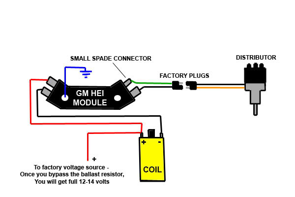

I replaced my port and starboard mopar electronic ignition systems with GM HEI electronic systems and it made a huge difference.
I upgraded to 12 volt coils and opened the spark plug gap to .045 and they start quicker and idle smoother.
Here is a writeup: http://www.rowand.net/Shop/Tech/MoparHEIConversion.htm
P.S. They still use the reluctor wheel in the distributor.
